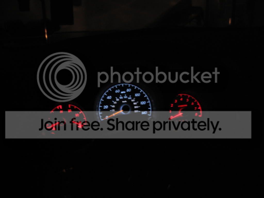

Like this?

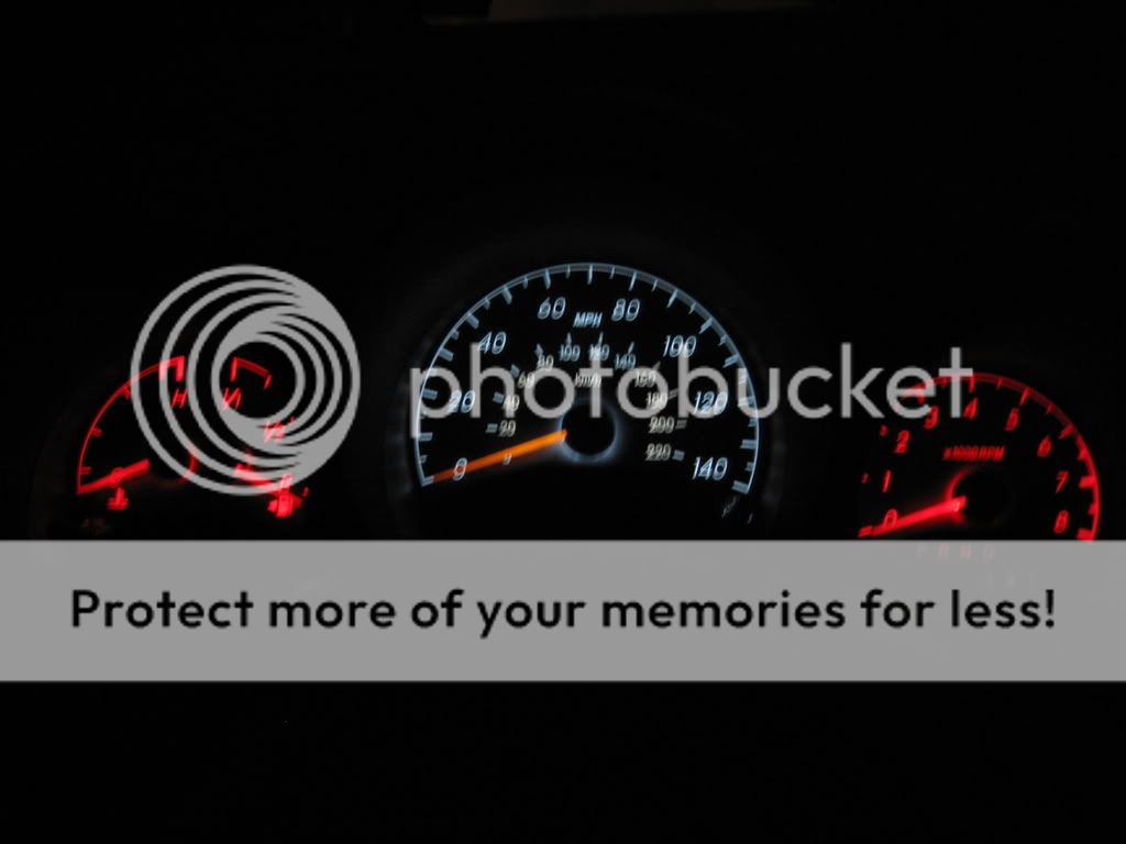

Or more like this
Video of that one changing color

yea yea like that..
i found it to be useful when you're driving in a bright sunny day and suddenly you pass underneath a freeway, ramp or tunnel or something and suddenly get dark and your gauges will be so hard to see but then your bright needle is there telling u were you are.
Old Sep 16, 2007 | 03:15 AM
  #525
engifineer's Avatar
Posts: 9,731
From: Minneapolis, MN
Yep, I prefer to have the needle lit all the time, regardless of whether the lights are on. Really stands out during the day.

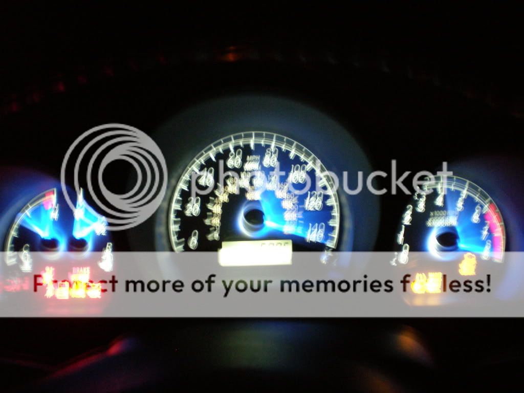

i just finally finished up my install. it took me forever to get this sucker working but finally everything works. this is some really tedious work and takes some basic skills to solder those tiny m&m mini sized leds. this is what my guages turned out to look like...

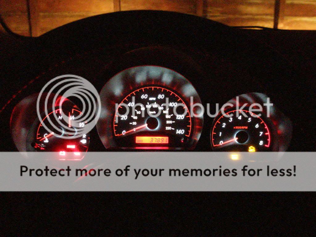

Ordered some LED's from www.garage1217.com and put them in today. I put in all white except for the LCD screen and the fuel indicator which i made Red to match the interior lighting of my tC. I also did the two tone look with the red vinyl sheets. Very happy with the outcome. novice at soldering but i was still able to do this project wihtout any mistakes. The picture makes it look a little pink but its not. The screen looks orange in the pic but its really a bright red.
