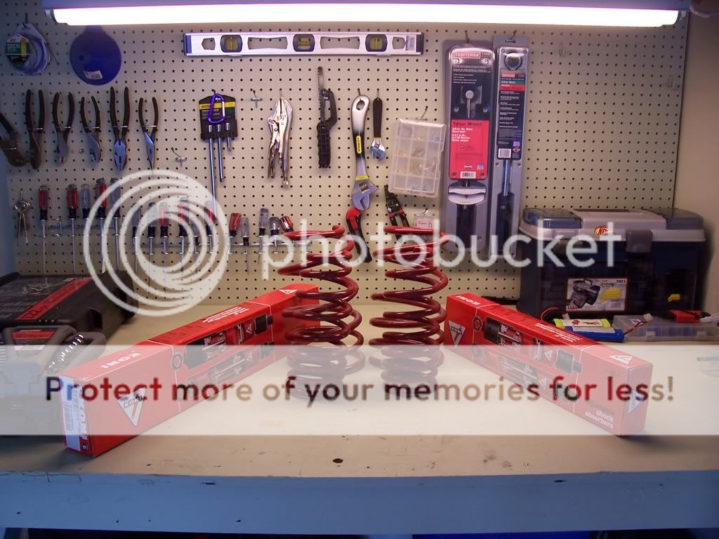

Tools needed:
14mm dill bit
Dermal and a metal cutting disk
Place to put strut oil

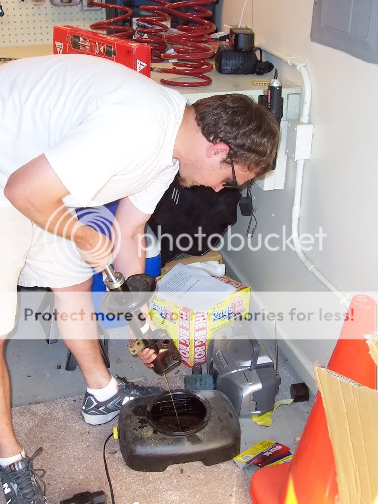

First Step
Removed strut and drilled a tiny hole in the bottom center with a small drill bit. I would recommend not drilling it like I did. If you have a vice that would probable be safer.

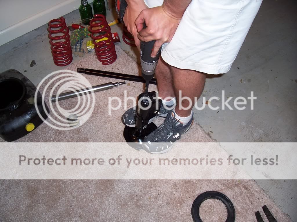

This is actually me drilling with the 14mm as you can see the top of the strut has already been cut off. This will just give you and idea of how I drilled the holes.
Koni says to drill the small hole then tape over. Then proceed to cut the top portion off.
I found it easier to pump the piston to get rid of the oil, via the hole you just drilled, before cutting off the top. I could only imagine the mess if you follow their instructions.
After the oil has been removed, drill out the small hole in the bottom of the strut with the 14 mm bit.

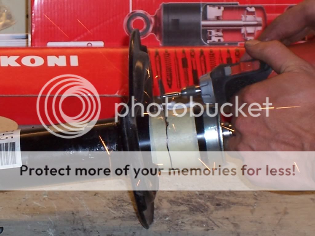

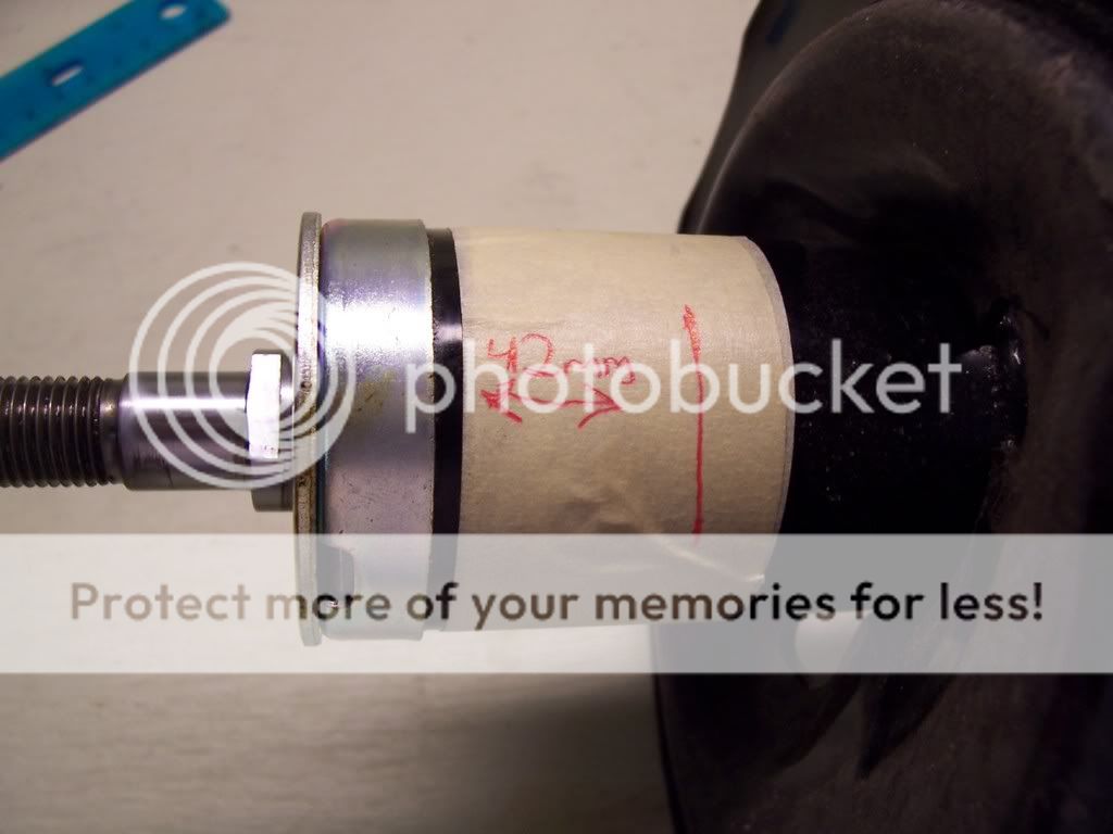

Next measure 42 mm from the top of the strut, not the top of my tape shown
I cut the first one off with a hand saw, it sucked. The second one I used a dermal tool with a metal cutting disk. It worked great and I got to throw some sparks.

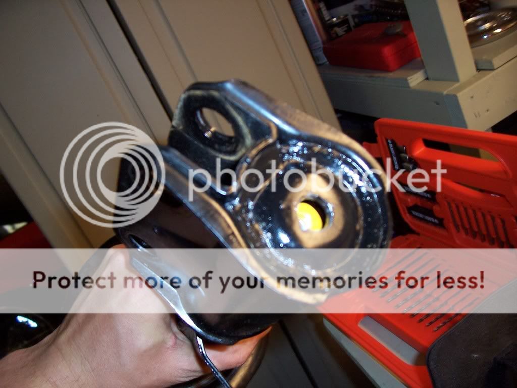

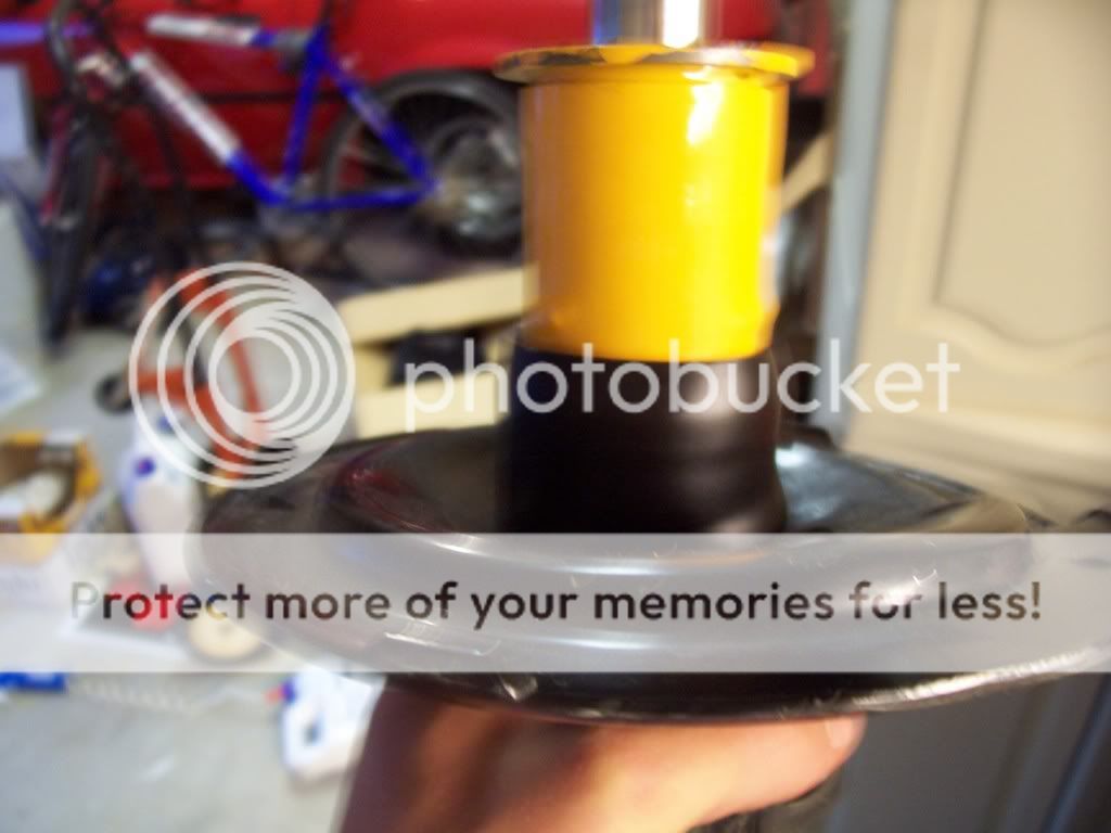

Next you just have to slide the strut into its new home. Pull down the rubber boot and put the bottom bolt to hold the strut in. I lost the first bolt on the road because of vibration. I would recommend locktite to prevent this from happing to you.
Finished product

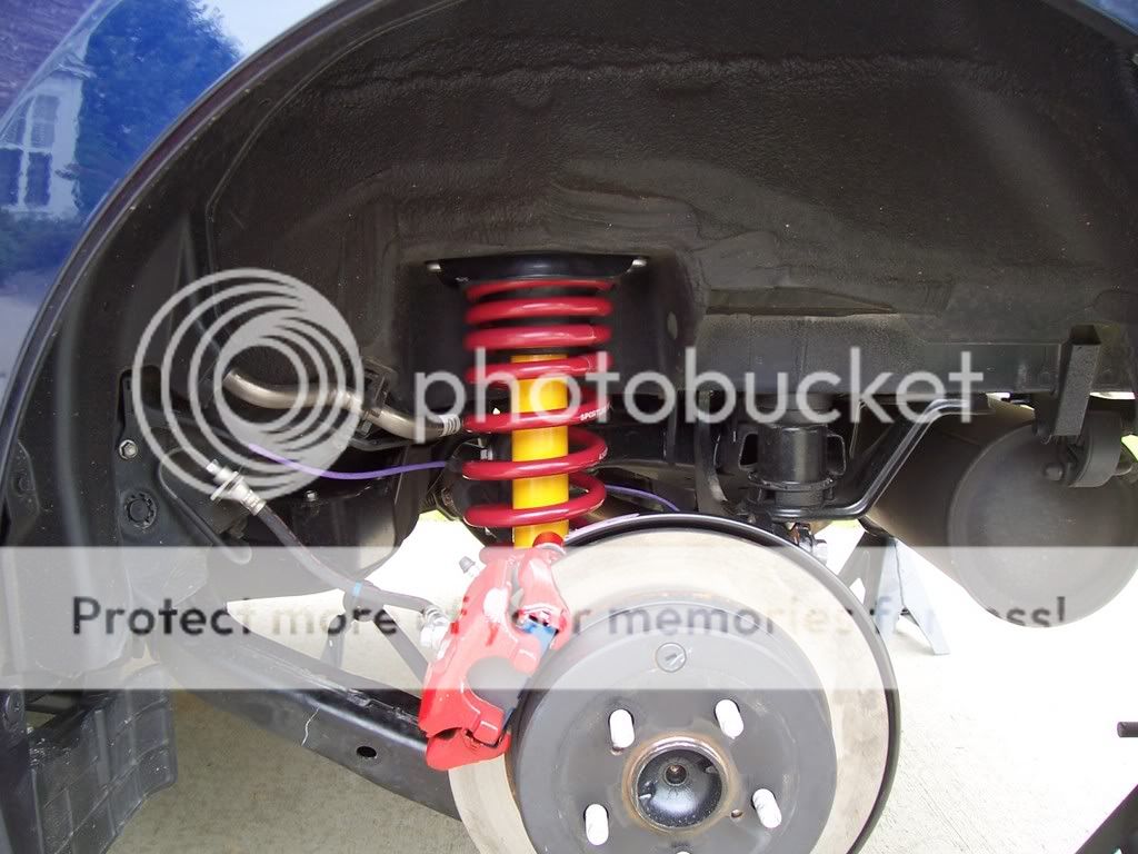

As for the rears, they just bolt in. Be careful no to put the spring perch in upside down when putting the rears together. I did, and so have a couple other people. The perch needs to be facing down. You will know if you did it wrong because the rear will not drop at all.
