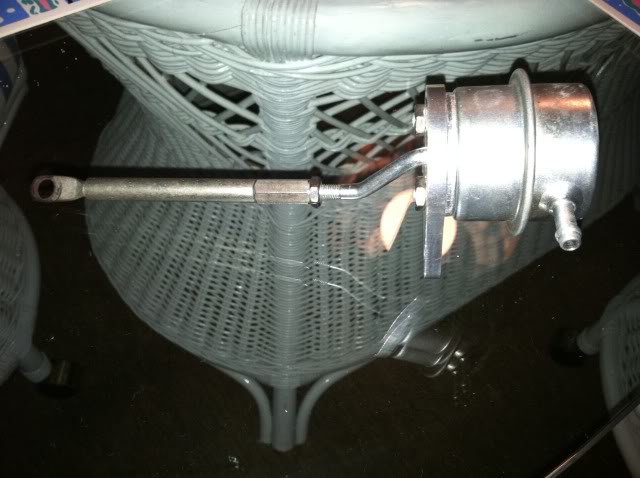

New actuator:

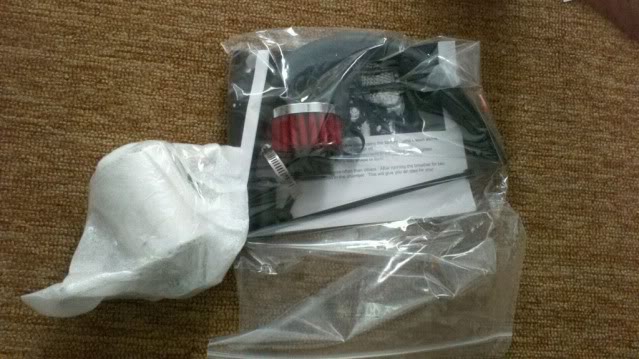

AGP catch cans:

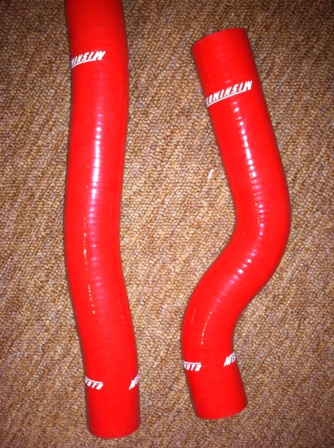

Mishimoto rad hoses:

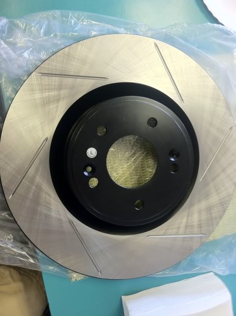

PowerSlot rotors with hawk pads:

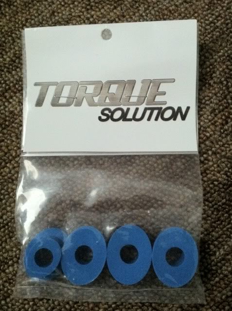

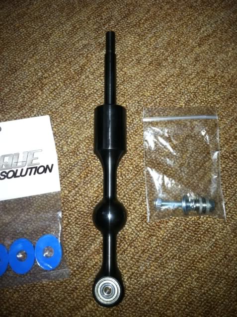

Torque solutions Short throw and Bushings:

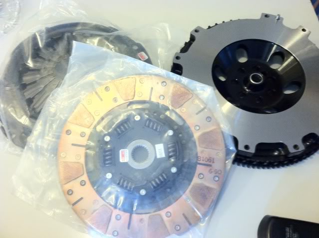

I believe this will help as well!
Competition stage 4 clutch and light weight flywheel! The clutch is a segmented ceramic material. I just received these in the mail today

Lightweight flywheel+drag racing dont really complement each other. Heavier steel flywheels add more rotating momentum off the line. Thats an old hardcore drag racing trick. Its all in the 60'. Top end cars have to play catch up all day long
Old Sep 19, 2011 | 06:16 AM
stevejohns29's Avatar
Posts: 1,086
From: Kittanning, PA
My car stock has a dual mass flywheel which really hinders performance. One guy actually broke his flywheel while at the track! The light weight flywheel is still much heavier than the one I had on my scion. This entire clutch assembly (flywheel clutch and pressure plate) weighs 33 lbs
Old Sep 19, 2011 | 04:13 PM
Prototype_xB's Avatar
Posts: 4,113
From: Goldsboro, NC
33lbs is a good weight
Stock i believe the entire assembly is right around 45 lbs? The major difference is switching from a DMF to a SMF.
