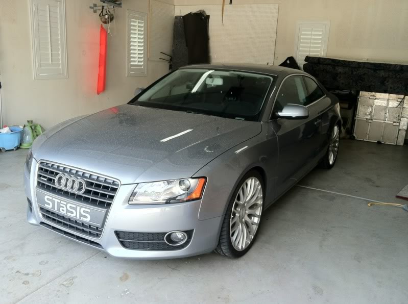

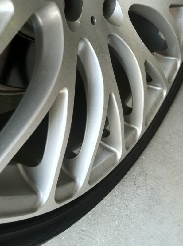

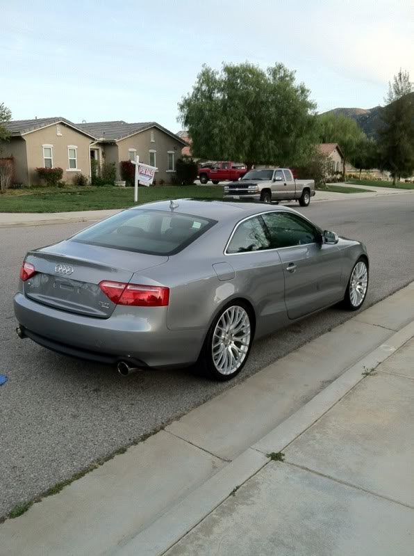

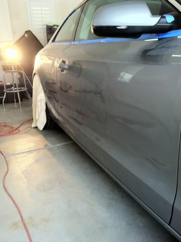

Took about 10 or so hours because I had someone helping me so it cut the time in half
Started with a hand wash
clay
polish/wax oil remove wash
Surburf pad with meg's 105 compound
Black finishing pad with menzerna sf4000 polish
Blackfire wet diamond sealant
Chemical Guys 50/50 paste wax
wheels polished, sealed, and waxed.
trim polished

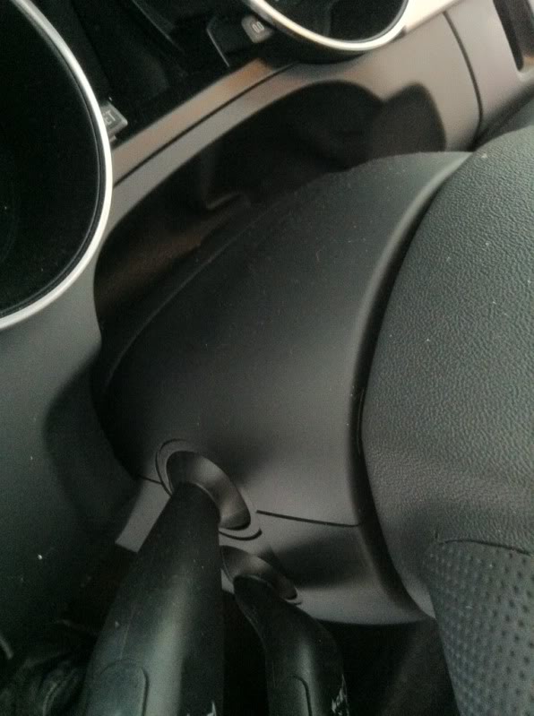

all carpets cleaned with a machine carpet cleaner
leather and plastics treated with sc-1
I totally forgot to take before swirl pictures, lets just say swirl city!

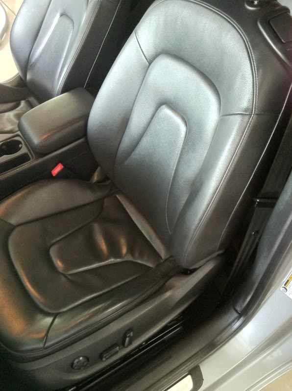

after sc-1

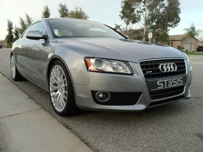

after shots

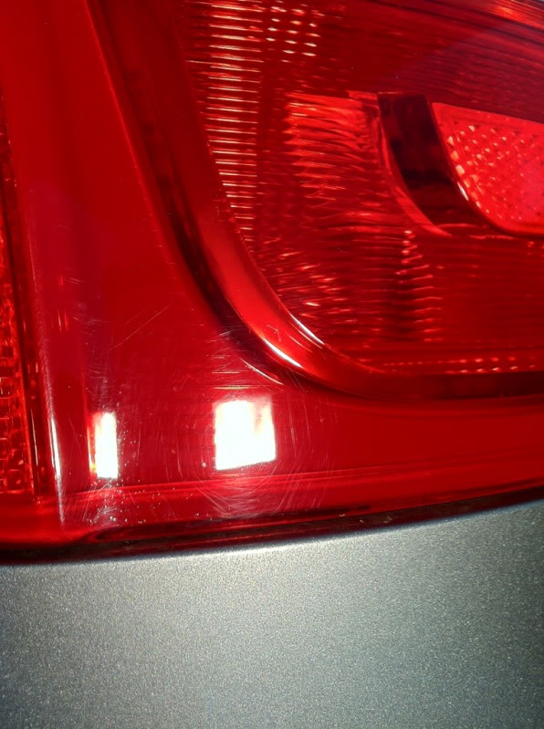

From: Bay Area/ Tracy, CA
no light-test pics? lol
Old Mar 25, 2012 | 06:45 PM
peyton331's Avatar
Joined: Feb 2011
Posts: 209
From: lake elsinore, ca
I forgot to actually. The tail light one was the only one I did. I normally start on the tail light and work my way around the car and I did one and forgot to do the rest or something
