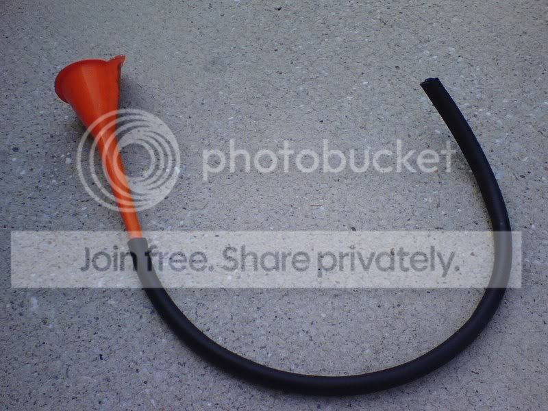

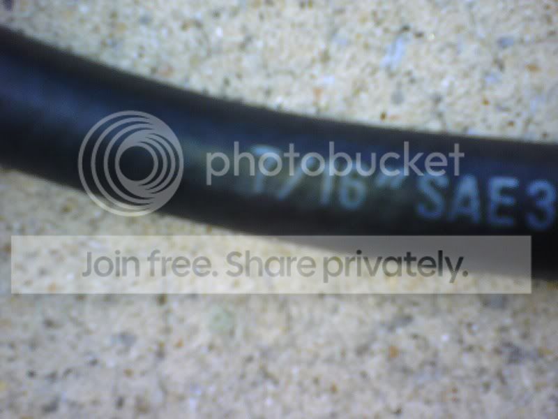

Step 2: Purchase about 2-3' of 7/16 rubber hose and a funnel to fit. This just helps pour the Seafoam into the intake manifold due to limited room with my strut brace.

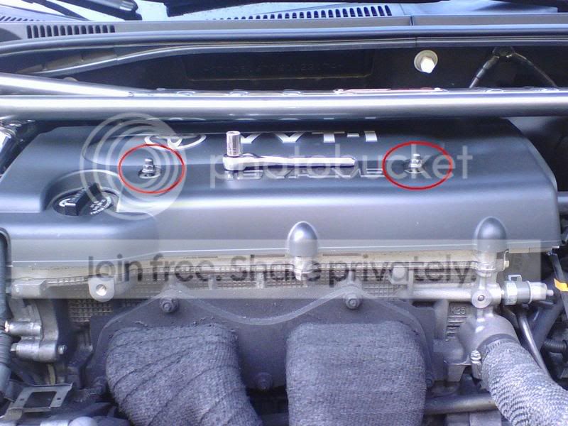

Step 3: Remove 2 retaining bolts on plastic valve cover

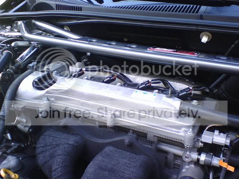

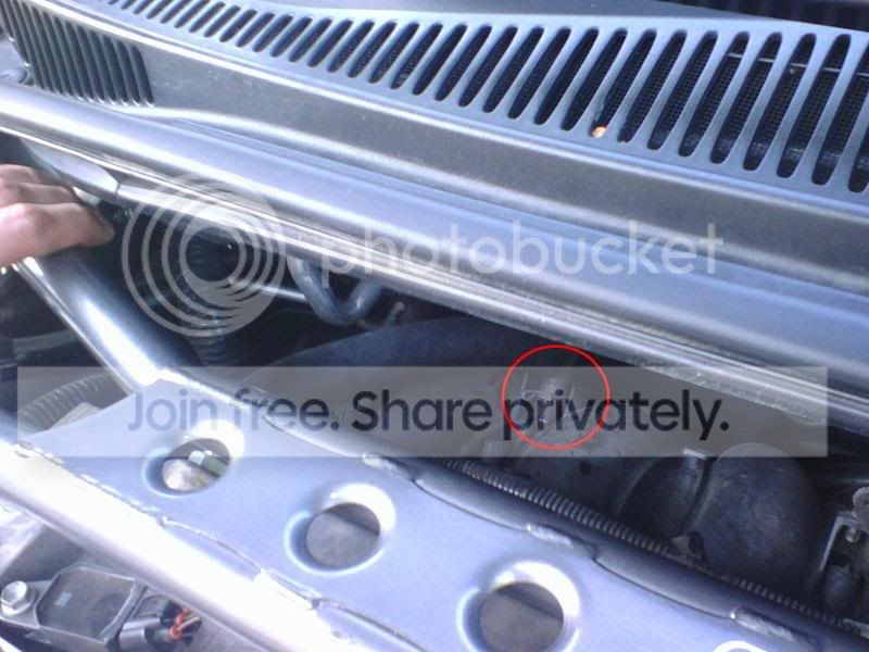

Step 4: Locate intake manifold suction line leaving back of valve cover.
Step 5: Attach funnel/hose setup to fitting shown in red circle above.

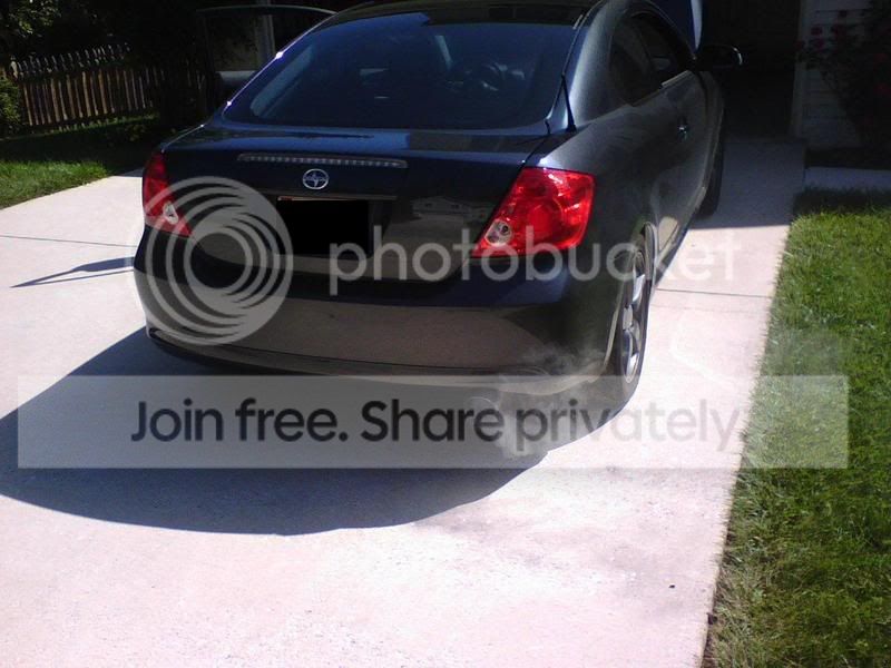

***You will notice white smoke coming out of your exhaust
Step 12: Rev engine through all of the power band for about 5 minutes and then let idle for about 10.

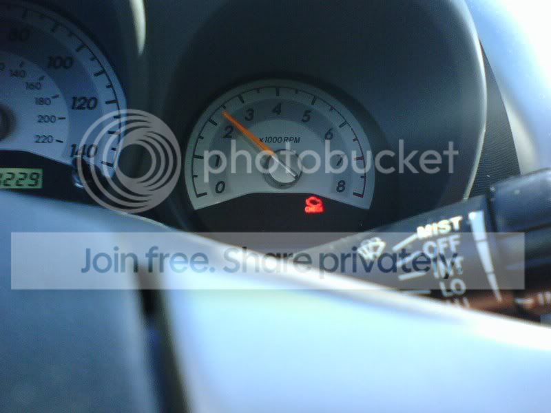

NOTE: If you notice your CEL come on, as mine did, take it to AutoZone and get it scanned.
I knew mine would come on b/c the startup after doing the intake treatment is pretty rough and you can tell it was misfiring.
I pulled a P0300, 301, & 302 code due to cylinders 1 and 2 misfiring along with 3 and 4 randomly.
That was only upon startup though and after 30 miles of driving after clearing the code, CEL is off and engine is smooth.

The reason the CEL came on is because the cleaner was poured in too fast! We do these cleanings all of the time at work and a special tool is needed. This tool allows the cleaner into the intake system at a pre-adjusted pressure to prevent the cleaner from going in all at once. This cleaning should take a total of atleast 20 minutes if done correctly with this tool and the CEL won't come on either...

Hey I'm going to be Seafoaming my tC tomorrow. It's got over 114000 miles on it, Im not too sure as to what line I should be using to suck the Seafoam into the engine.
I heard you can either you the PCV valve or the break booster line. Which line in this shown in the picture??
http://i141.photobucket.com/albums/r...831081101b.jpg
What are alternative lines that will feed all 4 cylinders?

some ppl would say intake but pls dont do that. especially if u have CAI or SRI...
just use the brake booster line. its easy
