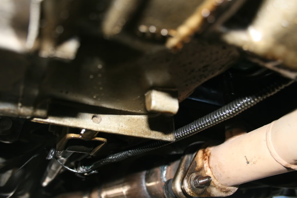

Ok here's a question for you Cory. I have a leak coming from my flywheel cover, and it's either my transmission seal or my rear main seal. Here are some pics.

^Seems to come out of there
What would you say this is? My oil level hasn't moved at all, and my thread on Honda-Tech didn't help me at all.

is this the same problem you were having a while back?
i though you determined that it was the rear main seal already?
kinda hard to tell from pics.
is that tube on the bottom of the trans? facing the ground?

It's the flywheel cover, the tube faces the ground. From what I've been reading, it could be the input shaft seal. I'm going to replace anything that's between the engine and transmission anyways, but I want to be sure it isn't a different seal. I kinda ruled out the rear main seal cuz my oil level hasn't moved at all, but I haven't checked the transmission fluid level yet. I've been looking at diagrams all day.

id check the trans fluid level first.
it must be some kind of breather.
if it was mean to be plugged chances are you wouldve leaked out way more fluid than that.

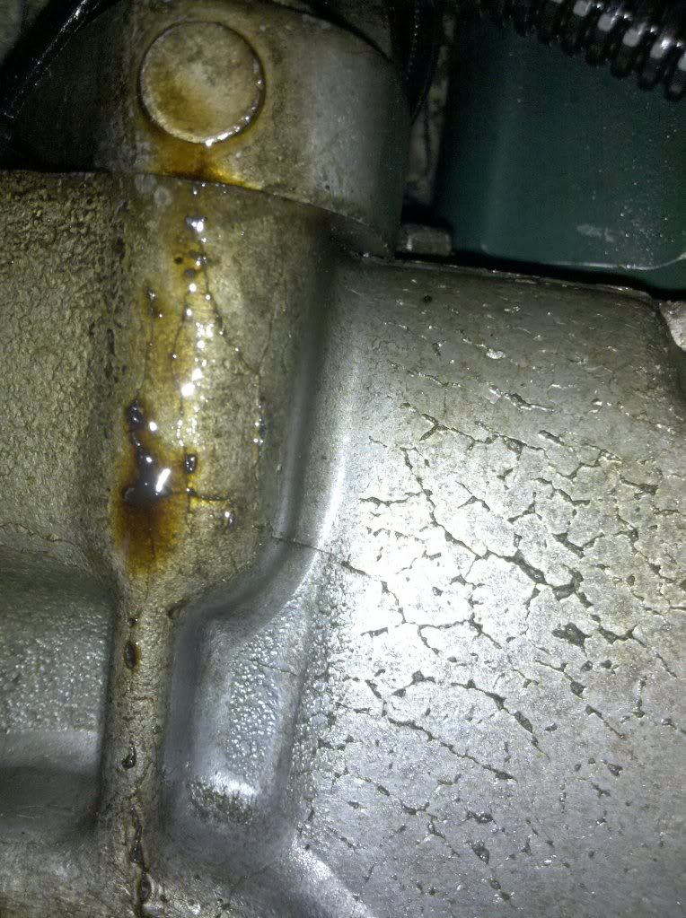

Here are a couple more pics. I don't get why the CV joint is covered in fluid unless it's that seal that's bad. But then that doesn't explain why the fluid moved forward.

Pics of the flywheel cover. The fluid likes to gather around that area.

idk what color your trans fluid is but that looks more like oil than trans fluid

yea tranny fluid is reddish

yea, i wasnt sure if honda fluid was diff.
even when its dirty you can still tell its red.

Nay. Honda MTF looks almost exactly identical to engine oil. I just checked my transmission fluid levels. What do you say about the axle seal being the issue?
