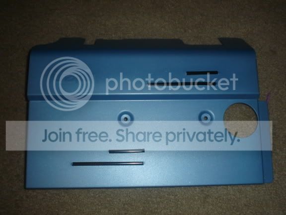

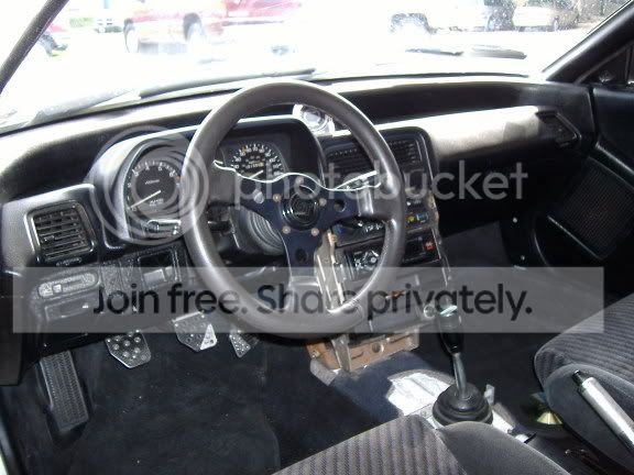

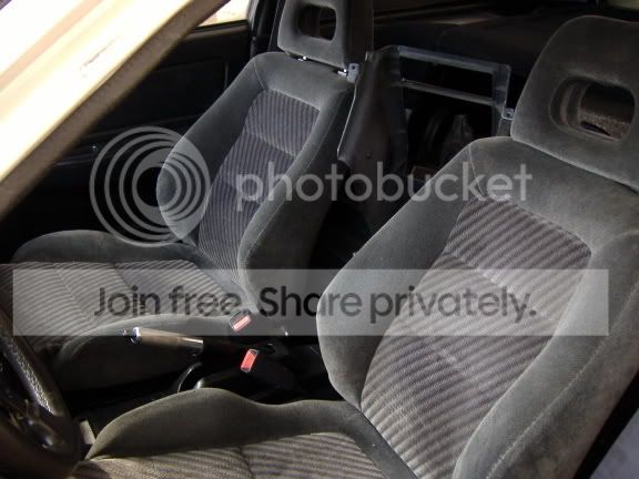

You can do it without sanding, however, if you ever used anything other than water to clean the interior i would suggest sanding.
There are paints specifically for that, i did my whole crx interior in black, it never chipped or faded, the interior was blue and i re-did it black, when i say everything, i mean everything, door panels, dash, center console, back panels, carpet, headliner, etc.
This are the only 2 interior pics i have. you can see where the carpet was painted around the shifter.
(Center console not in, i just gotten done putting an Si tranny in it)
You can see a lil bit of the door panel.

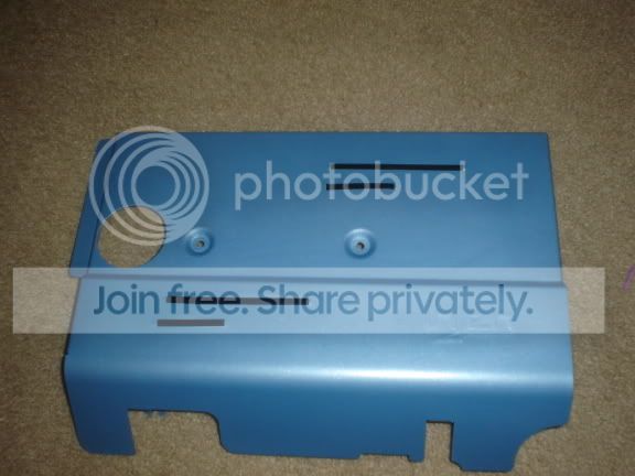

Another paint project of mine..

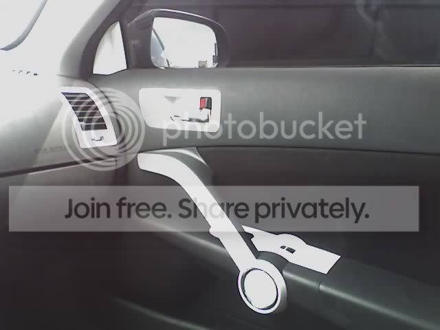

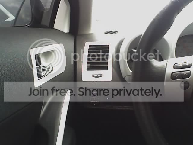

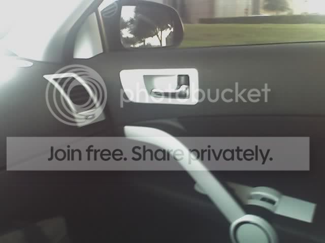

Old Sep 23, 2006 | 02:07 AM
-JoKeR-'s Avatar
Posts: 334
From: Houston

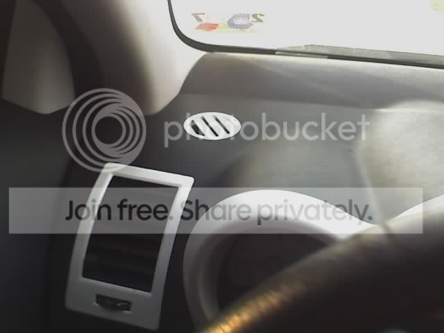

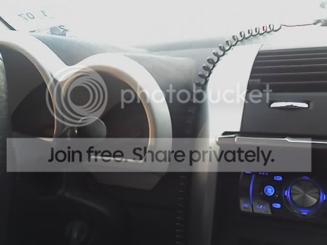

Old Sep 23, 2006 | 02:08 AM
-JoKeR-'s Avatar
Posts: 334
From: Houston
i didnt sand my pieces at all...i sanded one and it came out all gritty and soft....then i did the paint w/o the sanding and i think it turned out WAY better - im not quit done w/ mine just yet, i have the center piece and some things on the seats and backseats to finish up
sorry for the ____ty camera phone pics btw
