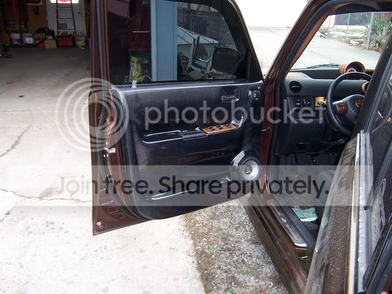

don't be scared to drill or grind just because its CF.
I was nervous at first to go at my CF door panels with my Dremel but as long as you have at least 2 layers of blue tape your good. And make sure you have everything suported well.
Triple check where you are cutting or drilling to make sure its in the right place.
Hell at $95 an hour I will drive over there and do it for you. Jeebus thats a rediculous shop rate.
I had to cut the holes for the speakers and shave a bunch of stuff.
