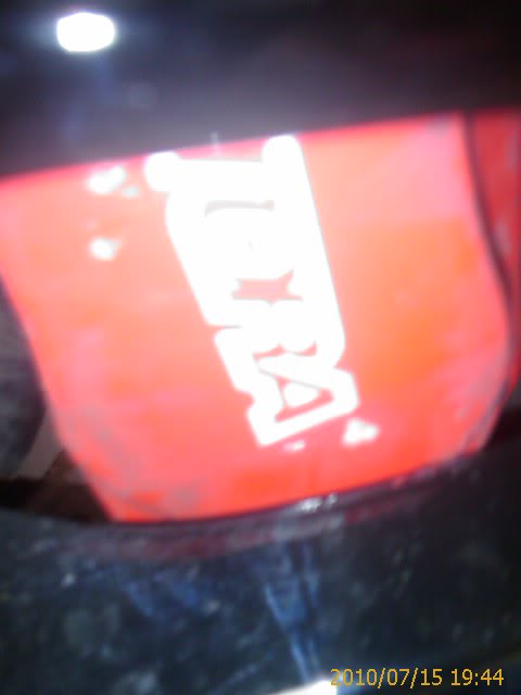

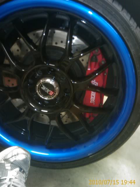

Finally got around to attempting to install a set of Rotora big brakes i bought from a friend a year ago.... after finally getting the old brake line off, rotor and caliper.. i got the new rotor and caliper on and before i connected the brake line and did bled them.. figured i'd put my wheel back on to make sure it clears... FAILED
18x7.5" xxr 006's
with no spacers on very clearly hitting the caliper, put on 2 spacers that my father in law had in his shop, just over 3/8" combined.. and the wheels clear the caliper by about 1-2mm.. but they spin free... bad thing is.. i couldn't get a lug nut on. it tried to catch but just missed.. even if i did get it started i don't think they'd hold on enough.
so... thinking longer studs is one option to run with the spacers. is that safe and how easy to replace the studs? or am i crap out of luck?
with them spaced out on the 2 spacers it puts the wheel just about flush with the fender. which isn't a bad look, cept for i'm on air bags and when dropped, now the fender sits just above the rim.
to get around that issue it give me chance to install some cusco camber plates.. and if need be space my fender out with that DIY posted in here. and think that should clear the fender issue.
ok rambling now and wife wants me to watch tv w/her.. so i leave you with some pics.. and ask your thoughts opinions.. new rims are out of the budget so if i cant make the kit work.. i have a kit for sale

1st off clean up those calipers, get the rotors turned and at least scuff the pads to be safe. 2nd never EVER stack spacers. Do it right, get 1 bigger spacer and longer lugs.
Calipers look good behind there...definitely plenty of contrast.

well.. i wasn't really planing on using 2 spacers each.. its just what was on hand...
yes longer studs...
sadly the caliper is after 1 full can of brake cleaner...
may as well see about getting the rotors turned since i wont be on the road for a while till get new studs

Just keeping your safety in mind. Hate to see you get it all together be going somewhere and lose it.
