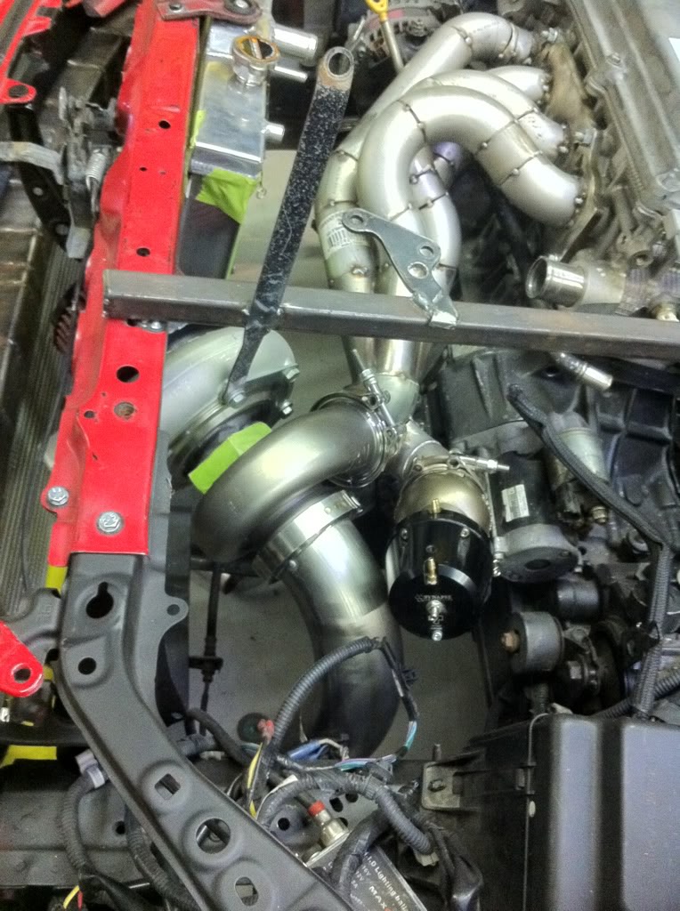

Wastegate is mounted need to get the pipe done now.

Will you be leaving the exhaust at that angle? I like the look, personally, but it sticks quite a bit out into the slipstream and will cause quite a bit of turbulence on that side of the car. I only mention this because I'm not actually sure what this car is going to be used for. Drag or circuit?
It really matters more if the car is going to be circuit tracked as the constant drag and turbulence created on that side of the car will have greater impact, especially at the speeds I'm assuming this setup will be capable of.
Also, is that a cat right before the exit of the pipe? If not, what the heck is that?
Overall, I'm very impressed with this build and looking forward to seeing how it all turns out. Keep up the stellar design/fab work!

^^ It looks like a flex pipe so that the engine can move and not disrupt the solid mount of the exhaust exit.

if that thing runs, you should do a start-up video so we can hear this puppy roar. I don't know about the rest of you but I'm interested in the numbers it produces and what it sounds like
overall, a very sexy build so far

Interested to see how the radiator hose will be run...also how close is the manifold to the clutch hydralics? Are you heat wrapping the manifold?

looks good....before you fire that bad boy up and melt the unholy !@#$ ou of that side of the bumper i would suggest making a simple metal cutout that fits about a few inches around that turbo exhaust port...so that way it doesn't destroy that bumper and end up looking fugly as all !@#$
simple photo shop to give you an idea... but even with a flexible exhaust flange that thing is going to be kicking out heat like crazy...
and yes this does look crappy...like 2 minutes of work.. sorry but you get the idea.

Thanks guys! And love the photoshop! I couldn't do that in 10hours but I can build a car! Lol but as far as racing I'm going time attack and auto x. That is a flex pipe. Also keep in mind I not done with the exhaust still have to get the wastegate pipe above that. I was thinking of doing a plate with both holes and it would have a cone that would cover both "less turbulence when racing" but dont worry I will defiantly film it at fire up! Also with 2-step. If you seen Rados awd 2step video that's what it will be like I bet. I will keep this updated for sure still waiting on 6gs of parts and still ordering more so it's going to have everything possible done to it lol. AlsO wanted the exhaust like that so you can really hear the cams.
The radiator I have to cut the top inlet off and angle it and then the manifold will be ceramic coated. The coolant line will be aluminum and heat wrapped. Clutch is safe I built 5 manifolds befor I got the one I liked and I know will push some power!

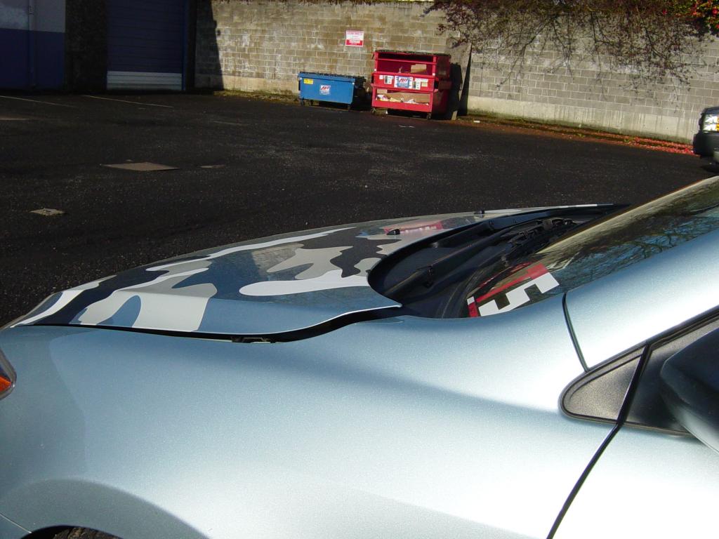

Few pics of my small recent projects.. badge, hood spacers, window tint & wink mirror

oooo kanchi is not gonna be happy with you about that new badge. he is on his high horse about that because he thought he was being unique because of how rare it is. Looks good ziggi. i like the camouflage hood and the extended mirror
