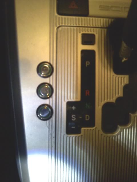

did some milling work at work last night. took the cover to my shifter box thingy and milled (nod drilled i used an endmill be cause the cut WAY cleaner) 4 PERFECT 5/8 size holes to mount all my auxillary switches. im going to instal them tonight or tomorrow morning i may need to do some light plastic trimming to get the nuts for the switches to not hit anything but it shouldn't be to hard. ill post up pics asap.
as for measurements. for these switches if you want to do the same thing. i spent like an hour taking measurements to find the prime location.
3.6 inches down from the top of the plate. then every .875" down. you can (fit a total of three here btw) the from inside the cutout measure .4375" in.
then for the fourth i milled a 5/8" hole in the center of the little switch hole cover.
now i know alot of people dont have end mills and milling machines so its possible to do this with a hole saw and then careful measuring and spot drilling
pics up this afternoon

as promised
heres some of the drilling process. first edge finding to locate exactly where i need to drill:

then i drilled them: they were very burry as you can see but a little exacto blade cleaned them right up. i also drilled a hole in the little switch hole cover

and heres what they will look like, ill wire them up later today,
