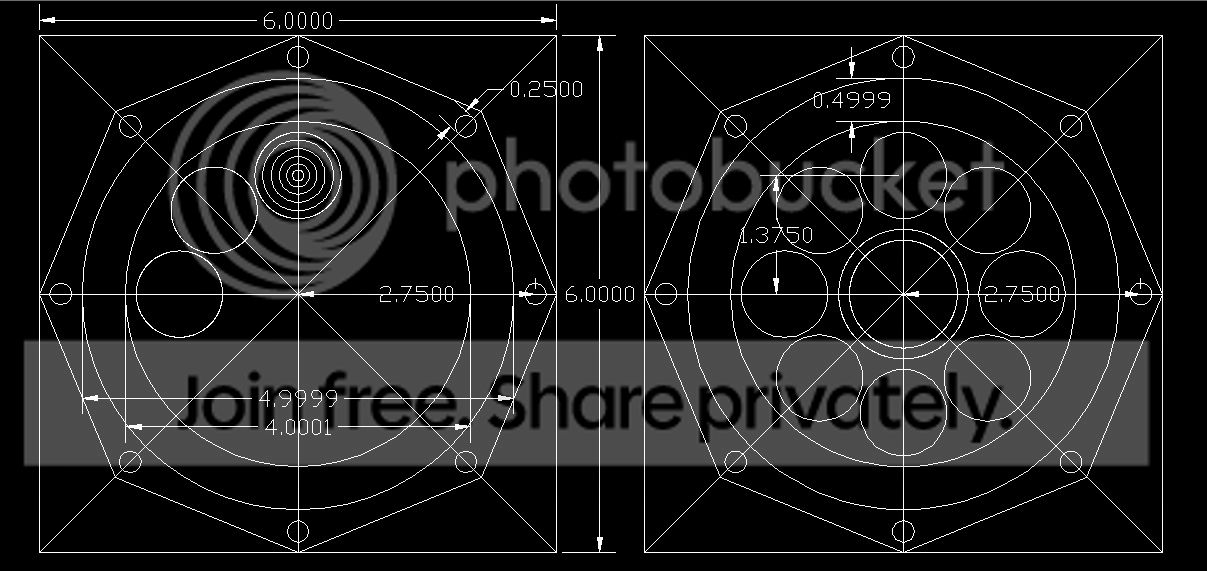

note, measurements that say something like 4.9999, should be 5.0000. the mistake would be due to my hand shacking on the mouse.
the holes on the outside are 0.25" holes for re-enforcement bars. these holes are only drilled half way into the top and bottom lids so that they may be epoxied into place on one side and become a "fit togethere" pattern on the top. there should also be a 3rd plexi ring that has a inner diameter of that of the outer diameter of the reactor tube which is 5". this outer ring should match the cut pattern of the top and bottom lid and shouldbe epoxied into place at dead center of the reactor tube and re-enforcement bars to act as a belt in the middle. the top and bottom lids should be bolt screwed in place nice and tight to suit upto 150psi without leaks.
