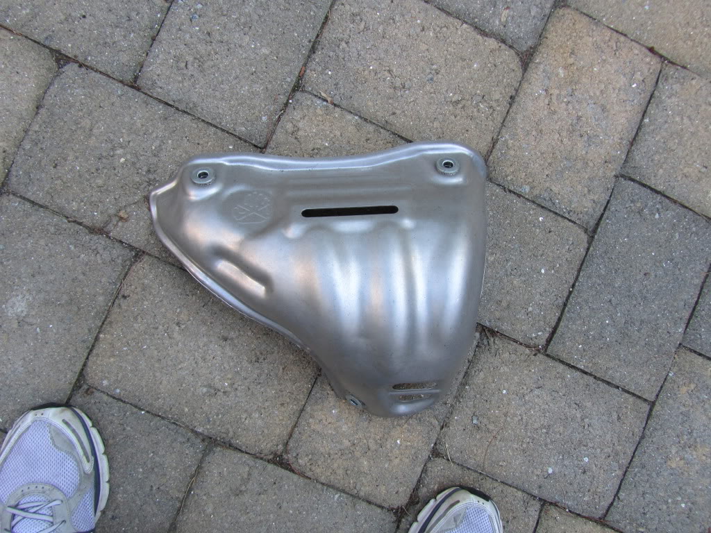

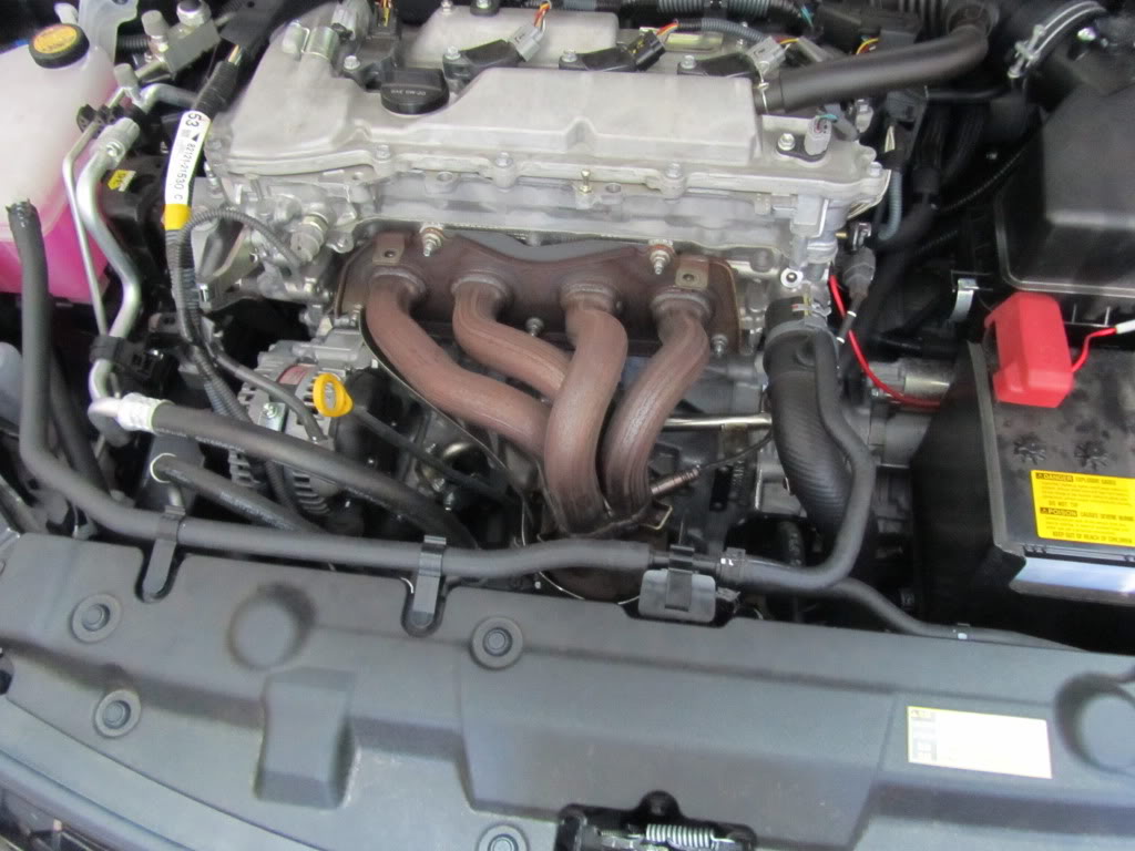

Flat Black high temp paints got bad reviews so I went with the gloss one, it still looks good but im gonna try paining it flat black over this aka having the gloss as primer

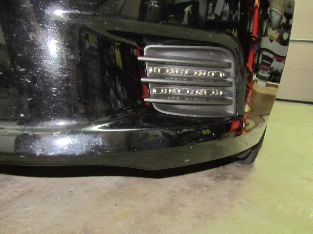

Originally Posted by errol
Can i see the LED fogs in day time with the lights off.
Name:  0712111153ajpgsidZLmR2r6cRv8NFL1vUOIGOKOHVbMaQO5dkl2FkiL2FM4rWlRk2F5lWrydzYUKT0z62FkWqL.jpg
Name:  0712111153jpgsidZLmR2r6cRv8SCjHkcgKX27Qj25Mc2Ful9hTg7Aqe7bMaMy3UMM2mW4ggvxRI4nl0EoqyYGY.jpg

thanks, did u have to sand it first? heat treatment? or any other prep? or just spray away
i'm new to high temp painting...
Old Jul 12, 2011 | 06:15 PM
  #212
Scion202's Avatar
Joined: Mar 2011
Posts: 2,102
From: Nashua, NH
im no pro either. I used windex to get the dirt off. Then 400 Grit sand paper for 5 min/until my fingers got tired. Then rinsed with acetone. 4 coats of paint.

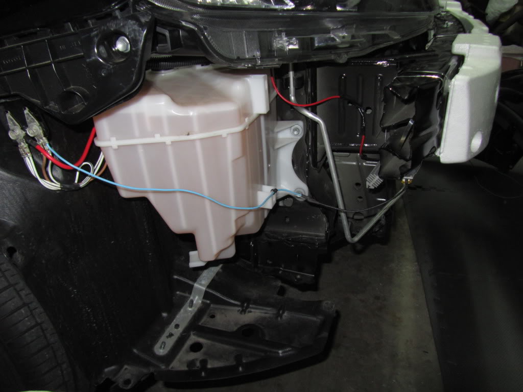

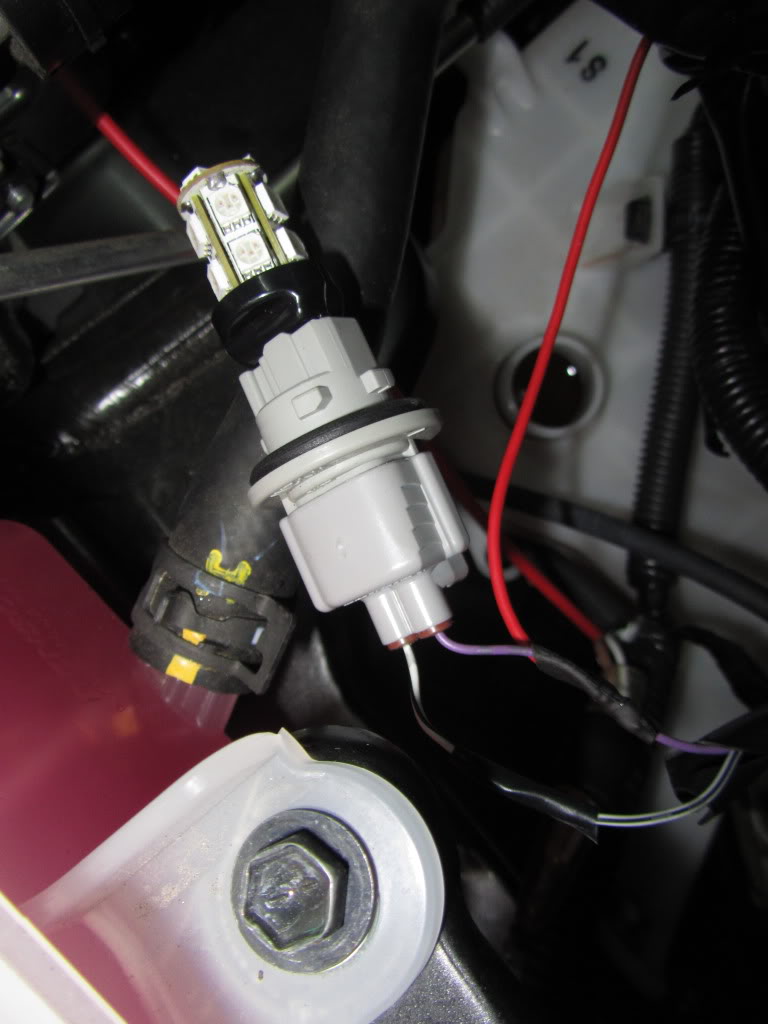

Step1
Splice into the Positive lead on the socket only.

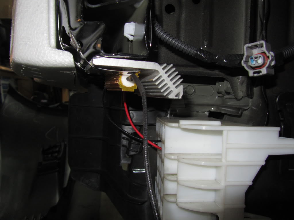

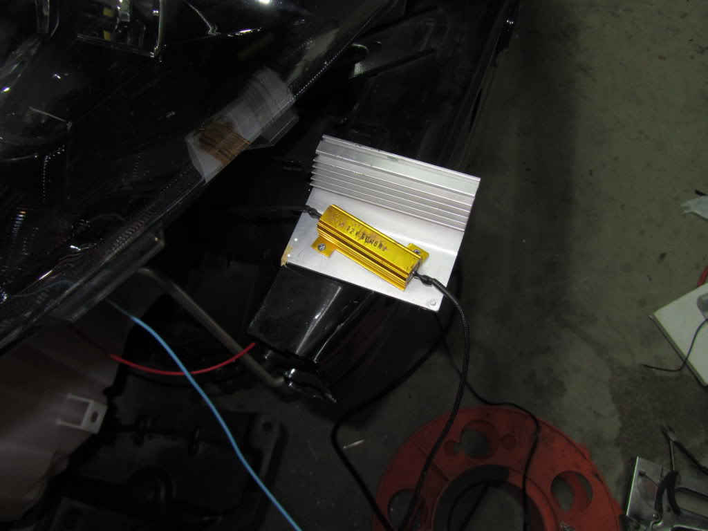

Step2
Find a location to mount the resistor. I picked the front bumper.
Step3
Sand the flat surface that the resistor will be touching or mount it to an aluminum heat sink.
(My friend had random aluminum heatsink around his house so I used em)
Step4
Connect the Resistor in parallel with the socket
-positive from the socket to one end of the resistor
-another end of the resistor can be grounded to anything on a car

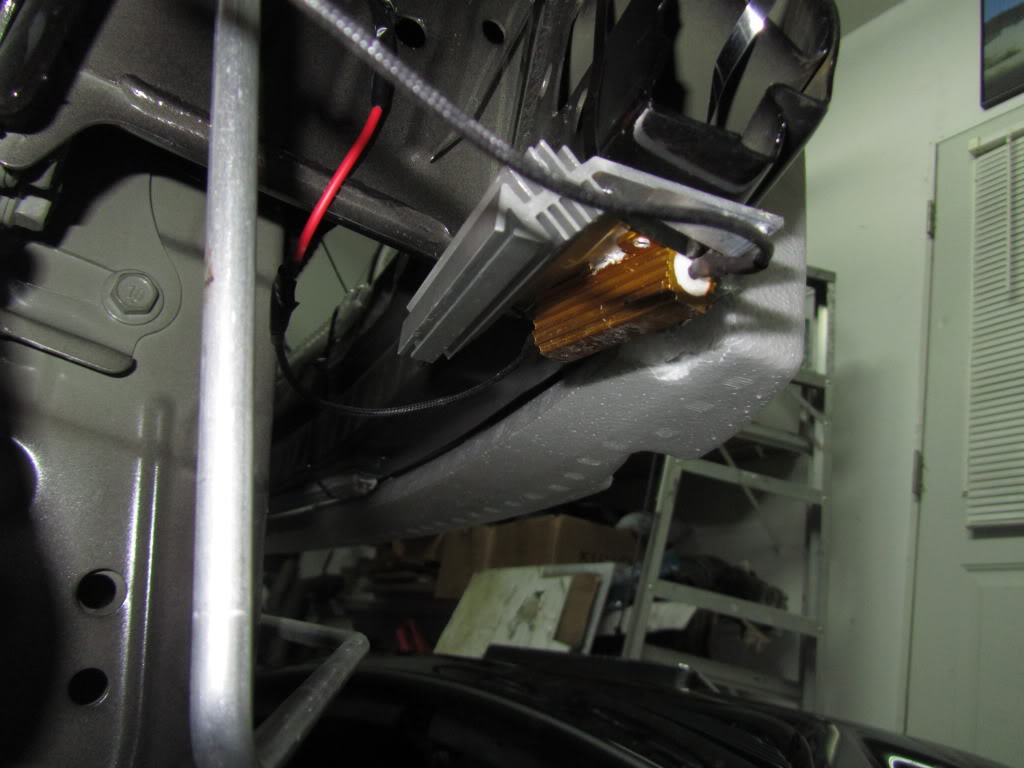

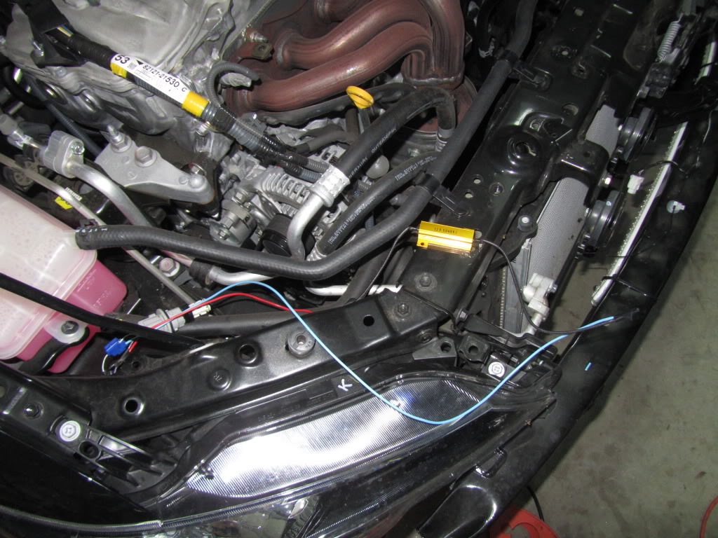

Step5
Turn on and make sure that no hyper flashing is occurring
Step6
Mount the Resistor with metal zip ties to a chassis or the aluminum heat sink to a chassis.
