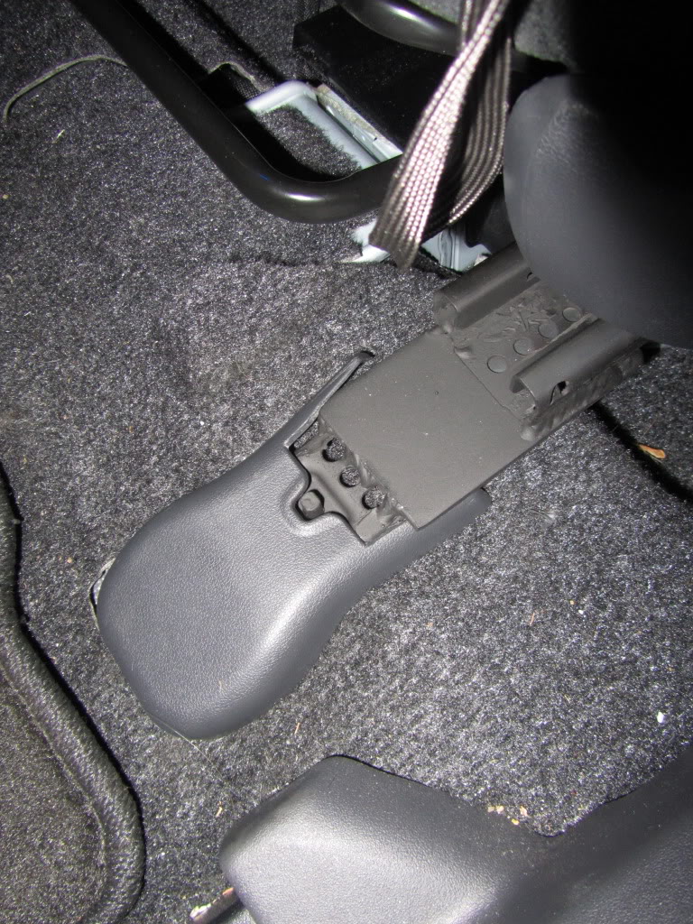

Re-welded 2.25 inches back and 1/8th up!

^ May I ask why?

Im guessing cause he's pretty tall, at least it looks that way from the angle he takes pics from. At 5'8" I dont have such problems......

haha I'm 6'3" with legs unproportionality longer than torso
driving 100 miles a day sux........to me this is THE MOST USEFUL mod, at times my innner quad would hurt so much that I wouldn't be able to sleep.
well worth the $180!!!

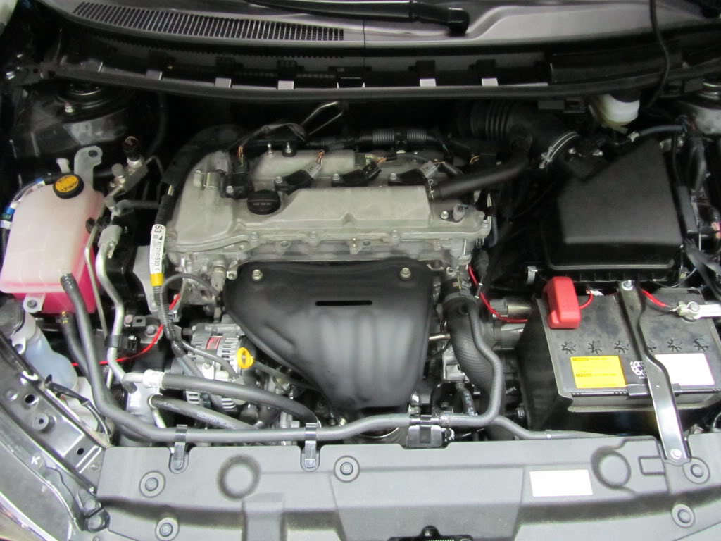

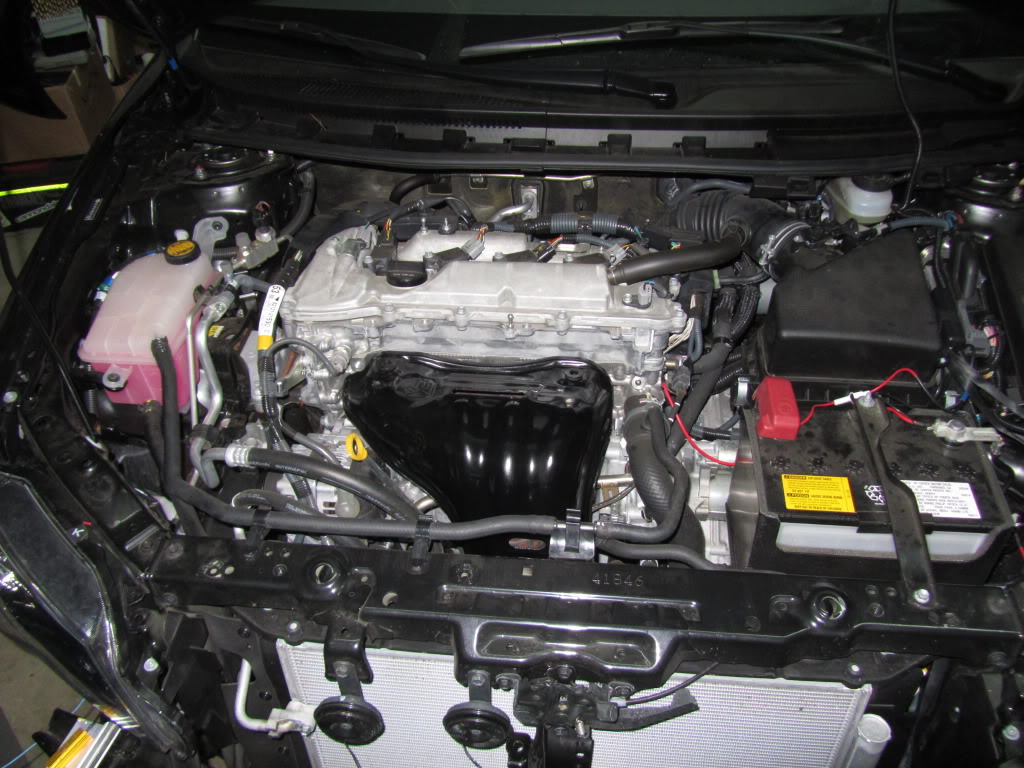

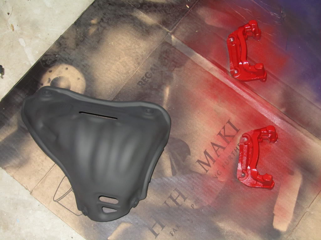

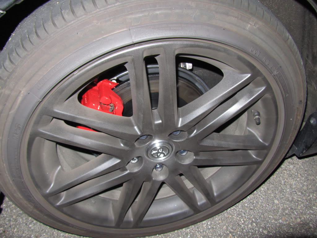

repainted the cover with matte black and touched up the calipers as they recomend to do additional coats after over a week
before
After
Matte black better matches the blaack plastics under the hood

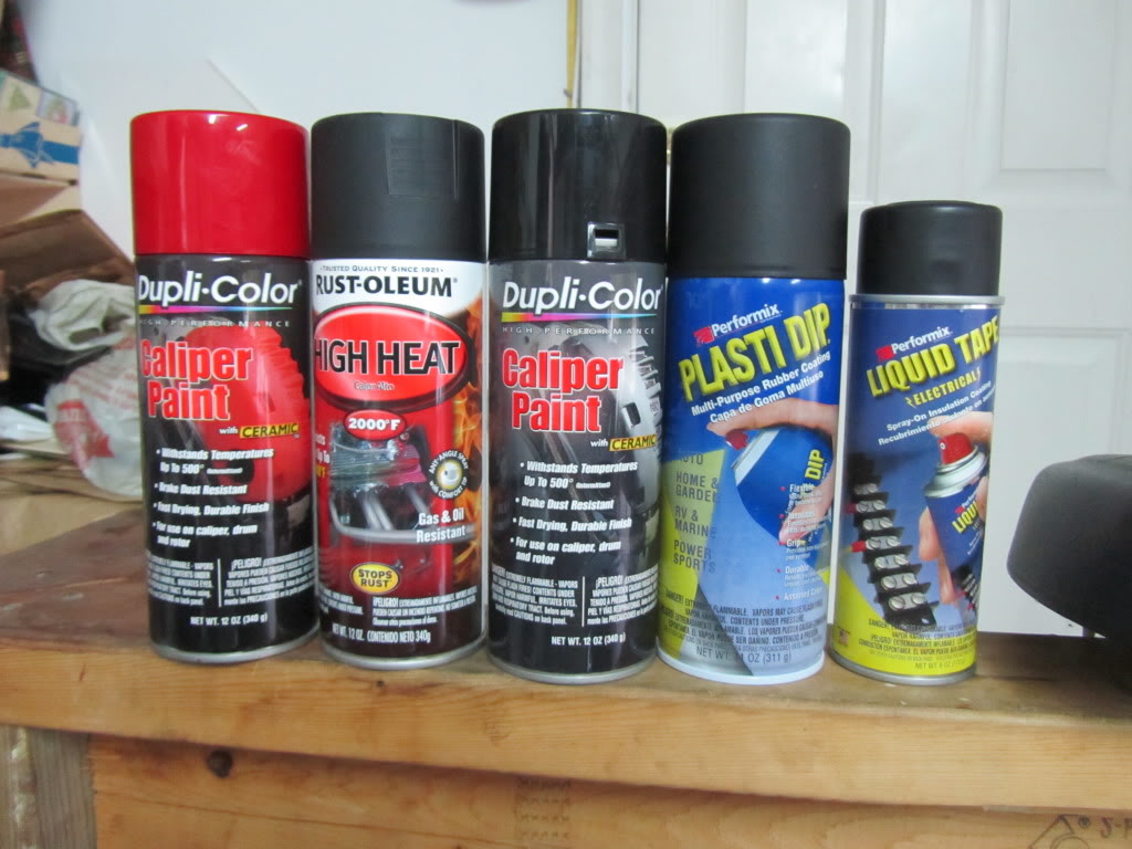

Painting Rear Rotors Black DIY#4
I used the black caliper paint

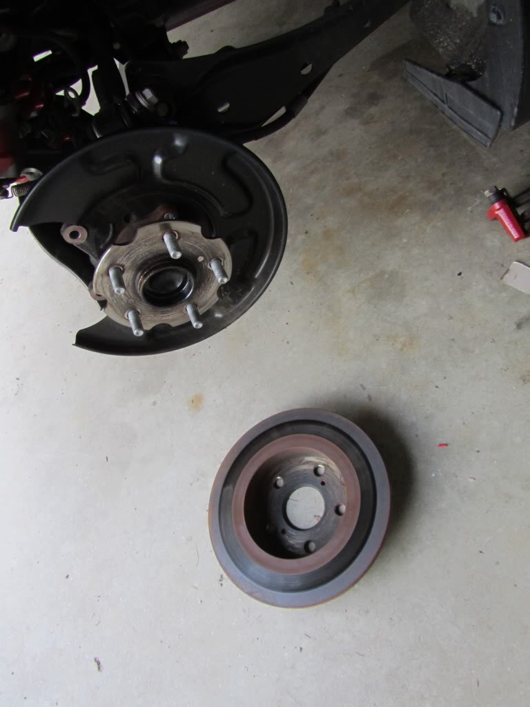

Step 1:
Remove the wheel and the brake caliper

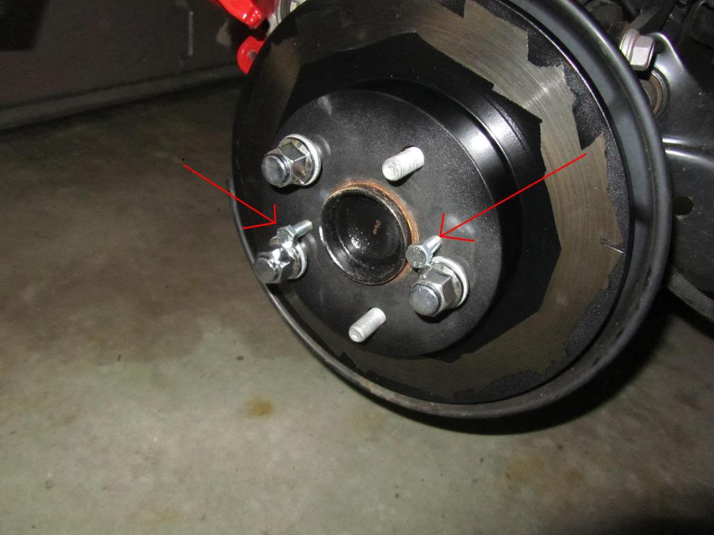

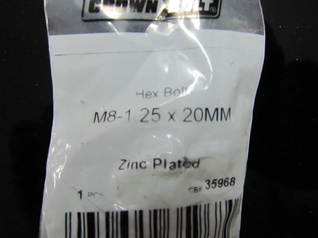

Step 2:
Take off the rotors by using 2 metal bolts that screw into it
I bought these bolts at home depot:

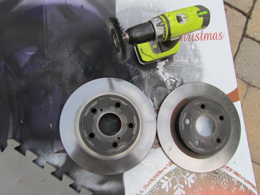

Step 3
CLEAN!!!
Using a drill and a wire brush clean the inner and the outer circles(the ones that rust). Try to avoid scrapping the surface that gets touched by the pad

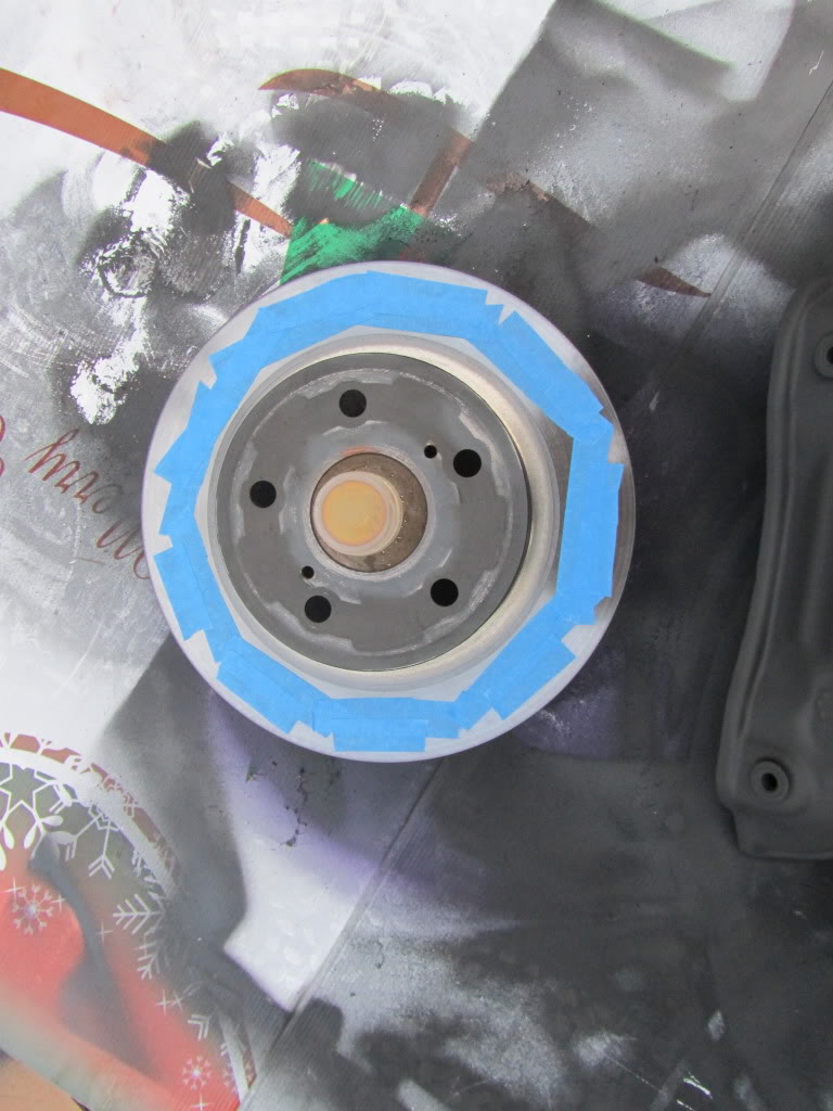

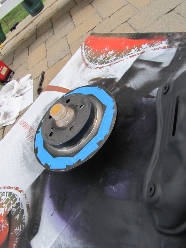

Step 5(Optional but recommended):
Mask off as much as possible to help out the the brake pads in the future
Step 6:
Using a Vitamin Water bottle prop up the rotor so you can paint the edges

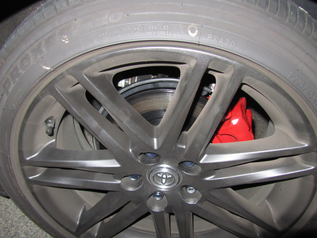

After Mounting:
After driving home from my friends house(very easy on the brakes)
On the way to work tomorrow I'll do some hard braking to get rid off the unwanted paint
