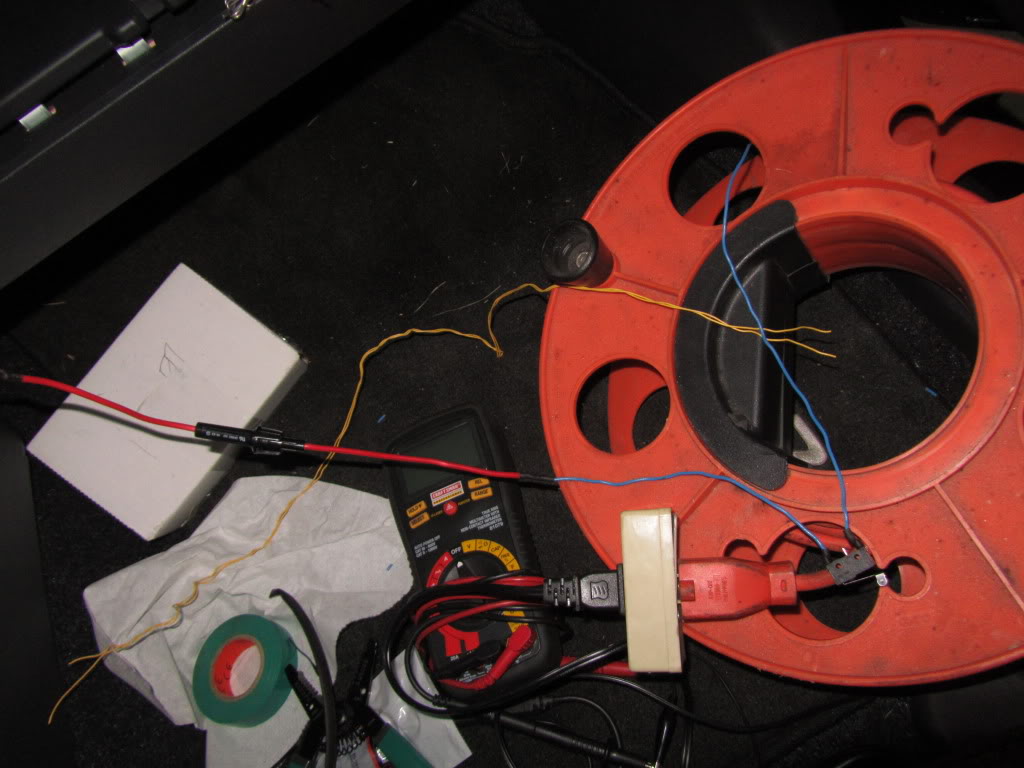

Spend 2 hours probing wires in both fuse boxes and found that both have plenty constant and Accessory/Ignition only rails so here is a little list of tips
Tips for finding and hooking up to a 12V source

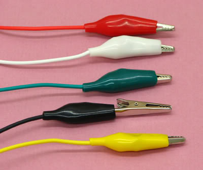

Equipment:
1. Multimeter
2. Alligator clips
3. Soldering Iron (DO NOT get radioshack brands, buy Weller on eBay)
4. Solder ( The more cancerous it is the easier it is to work with)
5. Helping Hands
6. magnifying glass
7. Crimpers
8. Wire Stripper
9. Crimp on connectors (always put some solder on the joint)
10. Shrink Wrap
11. Electrical tape
12. Heat Gun/Hair Drier

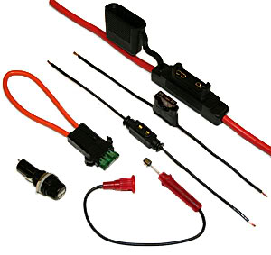

13. In-line fuses
14. Razor Blade
15. 0.5A and 1A fuses
Tips/Process:
1. Car Chassis is the ground
2. Every Black/White wire in the car is ground
3.
Start by looking around the area where you want to install your LEDs for any non black/white wires
4. Using a multimeter, connect one lead to the unpainted surface or a bolt with an alligator clip
5. Trace the wire to a plug or to what it is powering because there you will be able to find exposed leads. Otherwise use a blade to scrape a little insulation off.
6. Decide what you’re looking for:
a. Constant 12V (switch is a must)
b. Accessory 12V
c. Ignition 12V
7. Once you found 12V do the following to ensure that 12V is dependent only on what you want it to be.
a. Open and close the doors
b. Turn the key to Accessory/Ignition/Off
c. Turn on/off all the interior/exterior lights
d. Buckle up – (the line may be a warning LED/Beep for a seatbelt)
8. ALWAYS ALWAYS ALSWAY use an In-line fuse. The fuse has to be rated for at least 12V. What’s most important is the Amperage at which it blows.
9. Measure the amount of current your light draws using a multimeter
a. Connect one lead of a multimeter to 12V source.
b. Connect the other lead to the positive end of the LED
c. Connect the negative/ground of the LED anywhere to the chassis
10. The multimeter will read the current drawn.
11. Use a fuse that’s 3 – 4 times the current. ( I usually just use 0.5A fuses since superbrightleds have data sheets with current specs.
12. Cut in or merge in the fuse holder with solder
13. The other end of the fuse holder becomes your 12V and anywhere on the Car is your ground!

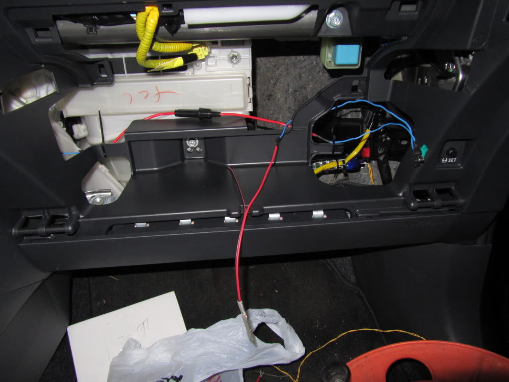

Glove Box LED Light DIY#5
You will need:
1. LED:
http://www.superbrightleds.com/cgi-b...FLS.htm#photos
WFLS-B30, using just 3 of them
2. Level Switch:
http://www.radioshack.com/product/in...ductId=2049719
the outside pins are NORMALLY CLOSED CIRCUIT so in this position both wires would pass electricity
3. In-line Fuse Holder:
http://www.radioshack.com/product/in...ductId=2102786
4. 0.5-1A Fuse

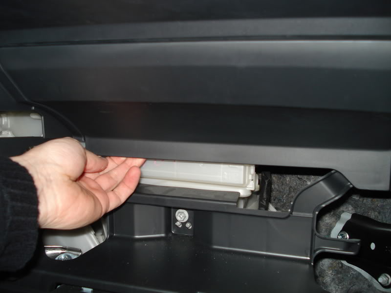

Step 1:
Pull off the stereo panel and disconnect the power plug from the clock
Remove the glove box by pushing IN from both sides.
Remove the black covering
(thanx 1stone!)
Step 2:

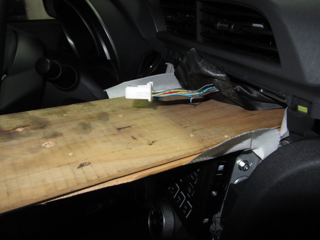

Remove the electric tape and open up the sleeve the power plug is in

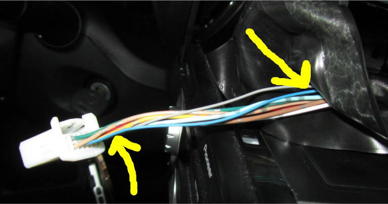

Step 3:

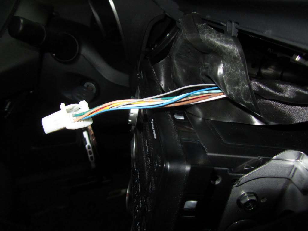

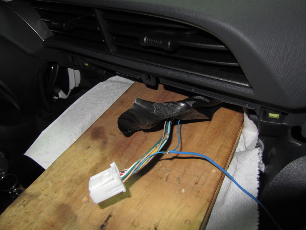

I found that the blue wire is connected to Accessory. You can try looking for constant 12V if you want. I did this out of safety - in case the switch breaks off or whatever else and the light would be ON inside without you ever knowing. Also I dont know what this is conected to so you must use a fuse, maybe this is connected to airbags who knows...
Step 4:
Scrape off some insulation or cut the wire. Solder on a wire.
Step 5:

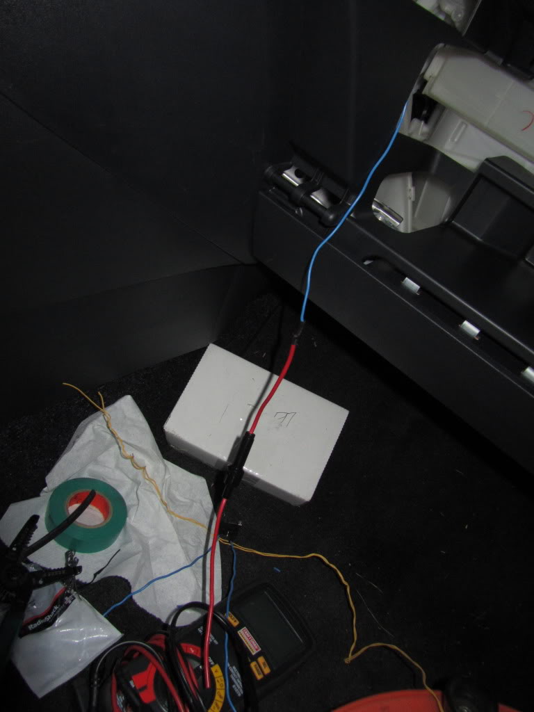

Feed the wire through the back of the stereo into the glove compartment and solder on the in-line fuse

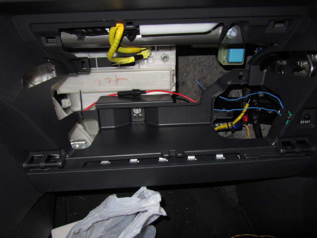

Step 6:
Solder on the wires on the outside pins of the switch and solder one side to the inline fuse holder

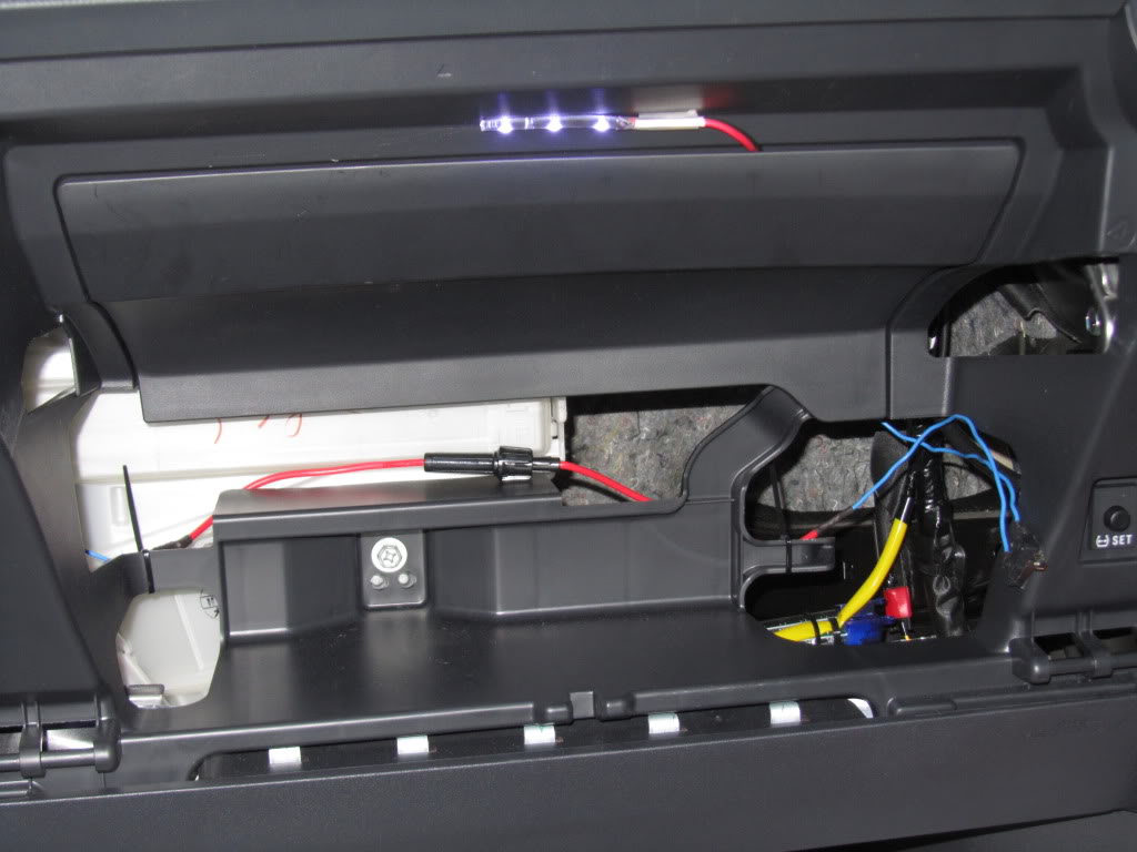

Step 7:
Align everything inside of the glove box compartment
Step 8:
Solder Positive side of the LED to the switch
Step 9:
Ground and mount the LED
Step 10:
Zip tie some wires and re-install the black cover. Turn on the Accessory

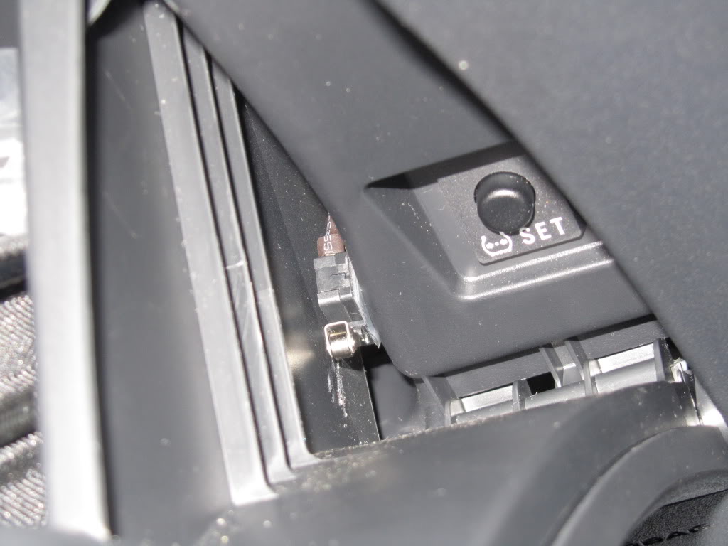

Step 11:
Aligning the switch is a bit tricky and will take a couple tries. I just used electrical tape to place it at the edge in the corner then re installed the glove box and tried closing it and listened for a CLICK indicating the the switch broke circuit. Once I found the perfect position I used 3M double sided heavy duty tape. I will secure it better in the future but for now it holds up EXTREMELY PROMISING
You're Done!

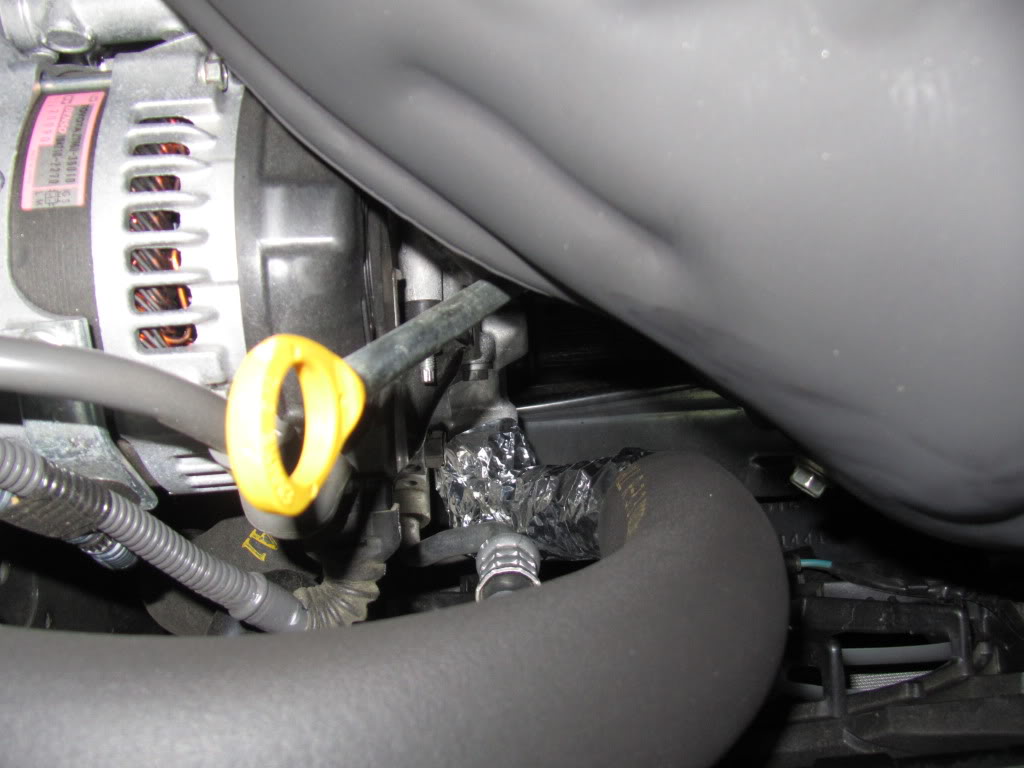

AC Line Insulation explained
HUH/WHY?:
Car manufacturers place the AC lines not where they should be but rather try to find the shortest way. As a result, they run way too close to the engine and the efficiency of the AC is decreased.
Stuff I used:
Armacell Armaflex 1/2 in. x 6 ft. Rubber Self-Seal Pipe Wrap Insulation - $5
http://www.homedepot.com/Plumbing-Pi...atalogId=10053
Armacell Armaflex 3/4 in. x 6 ft. Rubber Self-Seal Pipe Wrap Insulation - $6
You will need only a couple feet total
Also
Heatshield CFT Cool Foil Tape - any kind
Amazon Amazon
All you do is wrap one line that brings the cold air into the car.
If you want even more insulation then apply the aluminum tape on top of it
On my car the aluminum was only applied down by the exhaust manifold since you cant see it and the line is really close to it
Result:
The AC performance is definitely increased!
Before I'd run the AC on full and it would be just comfortable
Now I find myself shivering when it's on 4 or 3 so I can turn it down, which saves energy and cuts down on noise

Originally Posted by Backinblacktc2
Cool thanks I live in TX. On 100+ days the ac struggles to keep up so I'm going to try this!
yeah def, if you wrap the whole thing in aluminum foil then it will be even better!
but will look like ____
Originally Posted by SubtleStyle
do i DIY for it.
not much to DIY, just get 2 sizes of insulation for the metal lines and rubber ones(rubber lines are a bit thicker)
then measure and cut
DIY done!

i have all my leds wired to the rear dome. just put the wire and twisted it around the metal in the dome housing. then all the others are tapped into that wire. pretty easy and i really didnt know what i was doing lol
very cleva!
I was gonna look into the front dome and see how easy it is to tap into it.
I tried looking under the dash for door switch plug but it's OVERLY CROWDED
It's full of wiring and fuses from the alarm/rem start/tilt sensor/one touch windows/remote windows/few leds
SOOOOOOOOOOOOO it's a MESS
