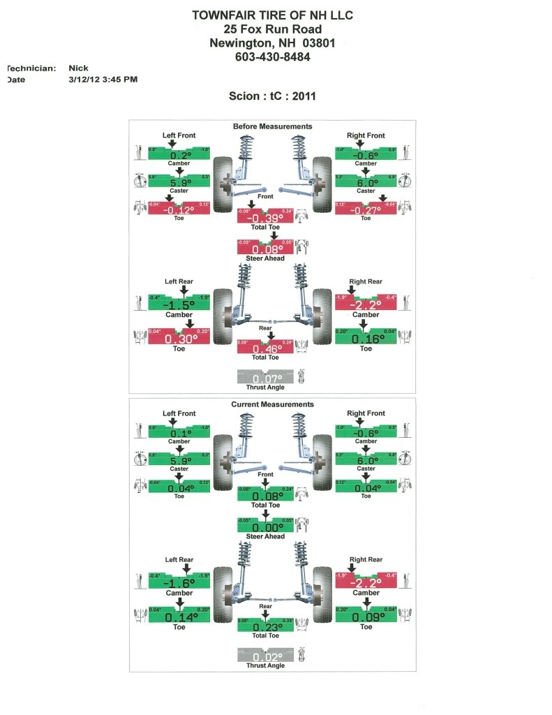

finally after 8 months on TRD springs I decided to get an alignment

rear is possible?
i have trd also. and it's been a yr now i think. havnt got an alignment yet. lolz

no, we cant adjust camber at all
with the alignment though it does feel more precise and responsive because the front wheels were pointing out b4 the alignment

I just wanted to let you guys know that I can definitely feel how much the cornering improved after the alignment. Before the wheels were pointing out a little bit which degraded cornering, now the car feel more like on rails! it follows through much more consistently and and you feel more confident taking a corner
