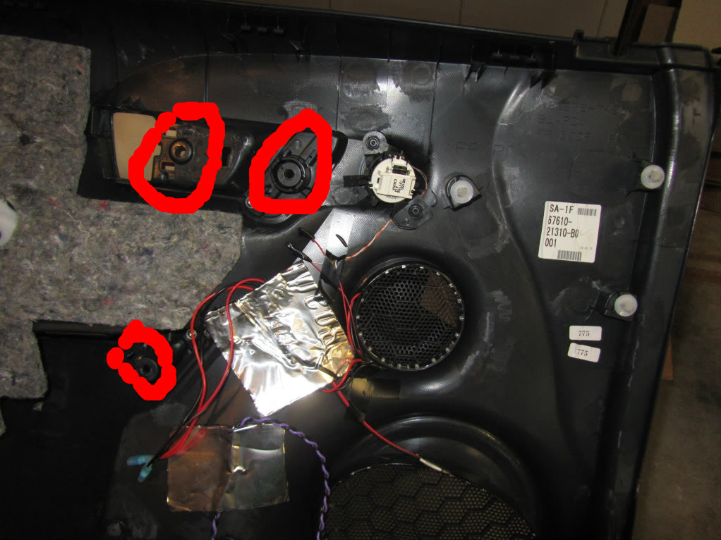

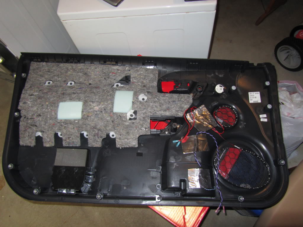

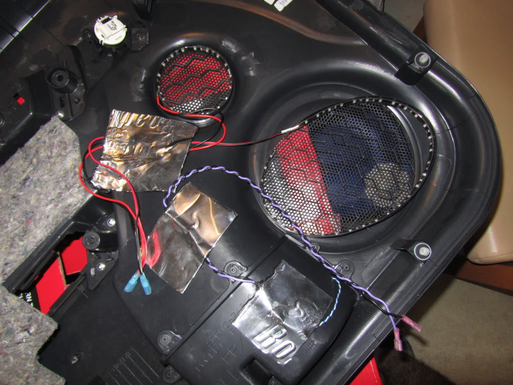

kinda a dumb question, but how do you pop the door panel off? one of the wires is rattling against the panel whenever i turn up the bass and i cant quite reach it by just popping off the panel by the door handle inside.

i believe there are 3 screws,
2 behind the handle trim piece
1 behind the locking/door opener handle
then you just pull really hard
