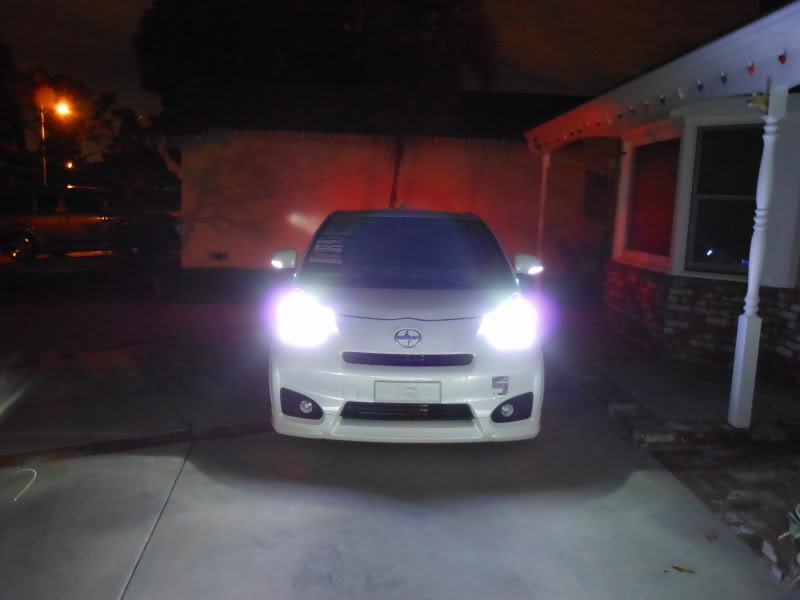

Congratulations on your new iQ and great choice on the HID's. I also have the 6K on mine and they are, in my opinion, the perfect brightness.
Looking forward to seeing your full shot.

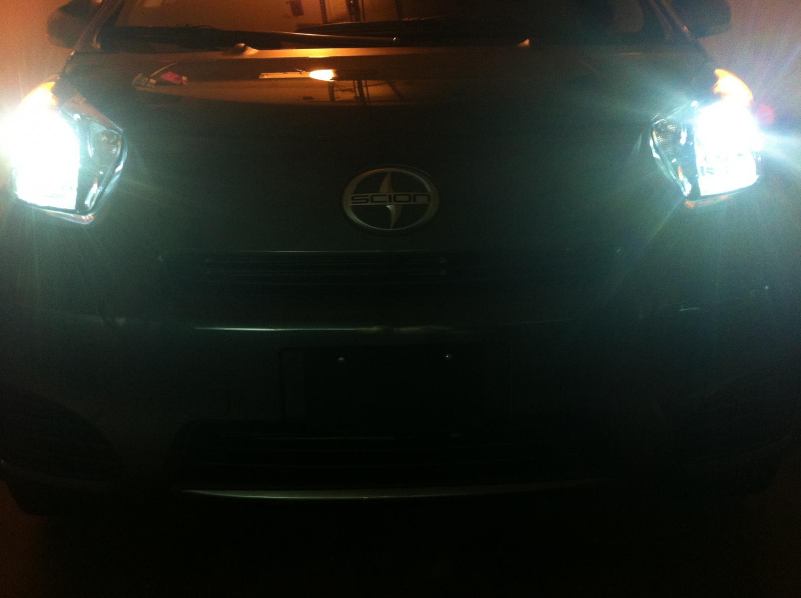

i was going to ask you how you got your lights to be such a sharp cutoff, mine are not as sharp of a cutoff line. its kind of blurred and not aimed in one spot.

this is my front view. do mine need aiming if they arent projecting correctly? because when they are facing a wall they area completely straight line across but when i drive its not aiming all in one spot.

Mine look like one side is shining farther too when I'm driving. They fill up the entire area in front of the car but at a distance the line is not a defined.

well I got mine to look like yours, i had mine turned the wrong way in the front. i had to twist it to lock in the headlight a different way. also the high beam do you know if its an h11 as well? i wonder if you could add hid to that as well. i dont want to add leds to that because i had those before and they are just for looks.

I wouldn't change out the high beams to HID, you want immediate light when using those and HID's take a few seconds to reach full brightness.
Glad you got the level thing worked out.
