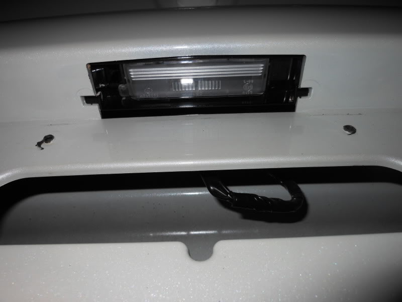

The light bulb can be accessed from the under side of the rear bumper just above the license plate...

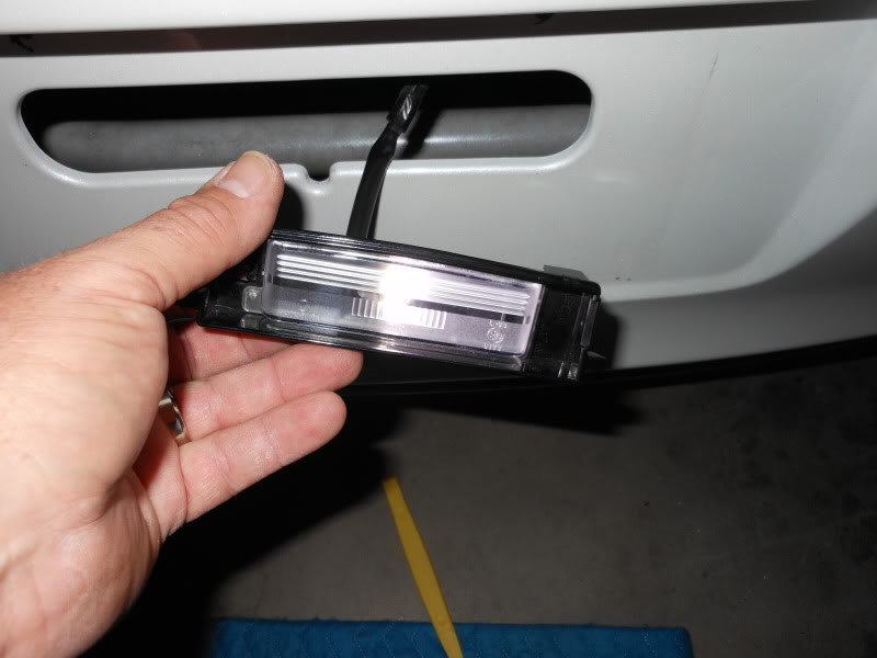

Using a flat head screw driver or a plastic trim removal tool, press on the black plastic tab located at the end of the lens and push towards the lens. The entire black plastic housing will be removed from the bumper, not just the lens.

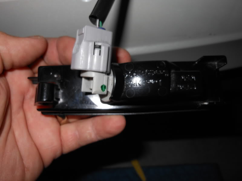

When you have the housing removed, turn the bulb socket counter clockwise and the socket will come lose from the housing...

Gently pull on the stock bulb and it will come out of the socket. Replace the stock bulb with the LED bulb and turn on the lights to check that it lights. If it does not, reverse the bulb and try again. The LED bulb is polarity conscious and will only light if installed correctly.
