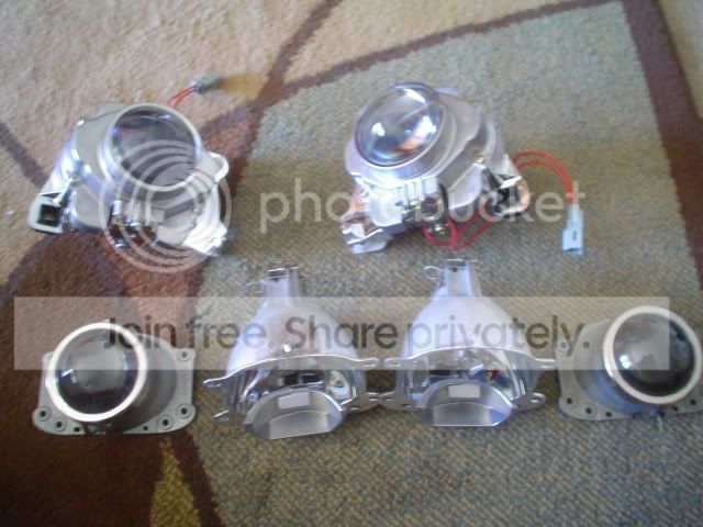

Since getting these I was wondering if someone had some previous experience with any Bi-Xenon projector? I am trying to setup the FX35 projectors to flip to the high beam when I turn them on the high beam in the car.

OMFG! Excuse my netlingo. I finally got some free time this afternoon and decided to go ahead and mount up my TSX projectors. Well after five hours, two of actually installing it and three aligning the freaking thing level.
Let me just let anyone know who wants to retrofit a 08 HL with tsx projectors beware. Spacers are needed, drill your holes perfect. I was off less than 1/32" and my right side projector has a slight tilt to it. Well it was around 11pm when I got everything adjusted with the right side I thought about the left and decided to do it tomorrow.
The projector itself is amazingly bright. It is 2-3X brighter than the stock projectors. I noticed that the stock projectors have frosted lens and a set of clear tsx ones or some custom ones would improve the output of the stock projectors. I might try a clear lens on the left side to experiment.
Tomorrow I plan to mount the left tsx projector and taking a few pics for you guys. While I had the light open I was trying to figure out how I am going to mount the fx35 projectors in the highbeams. It is going to take some serious mounting work to get it set up inside.

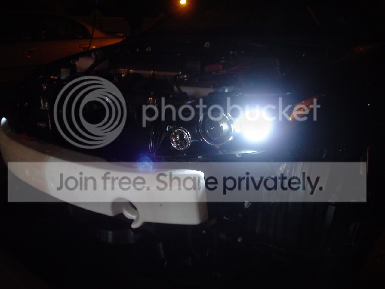

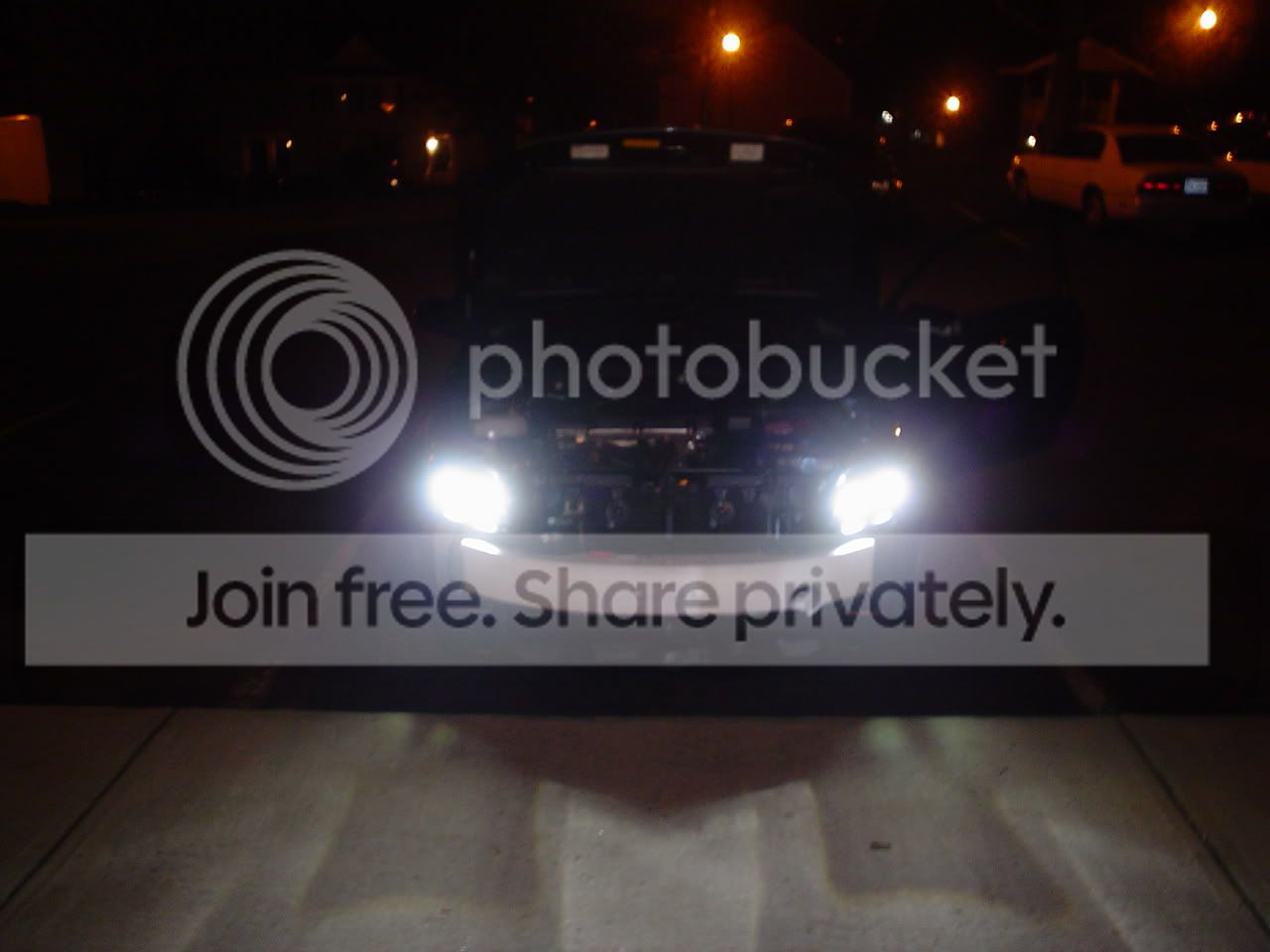

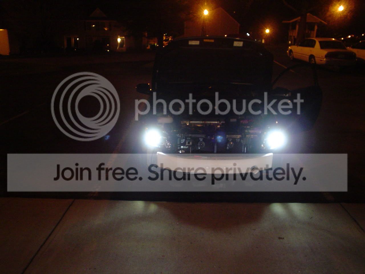

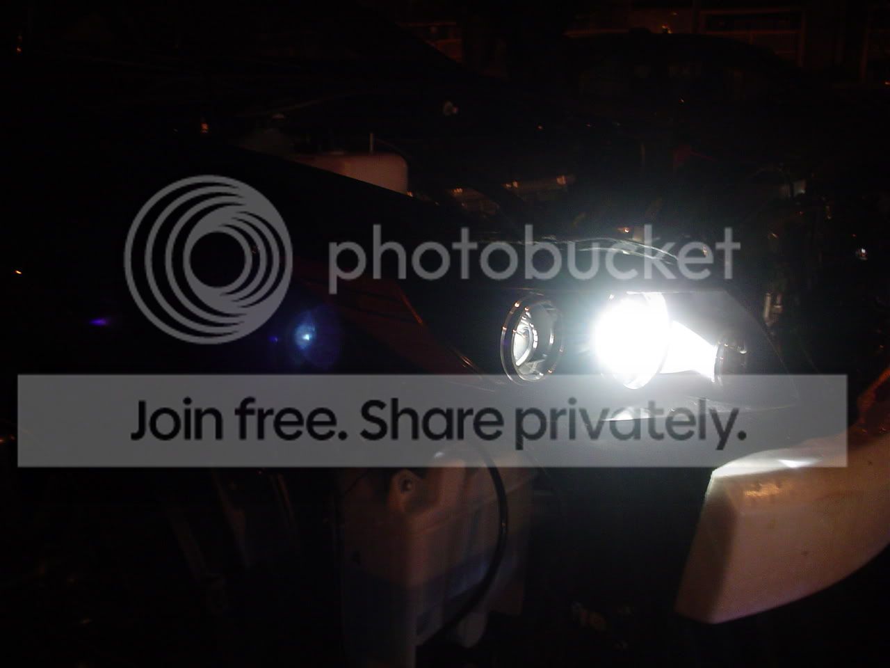

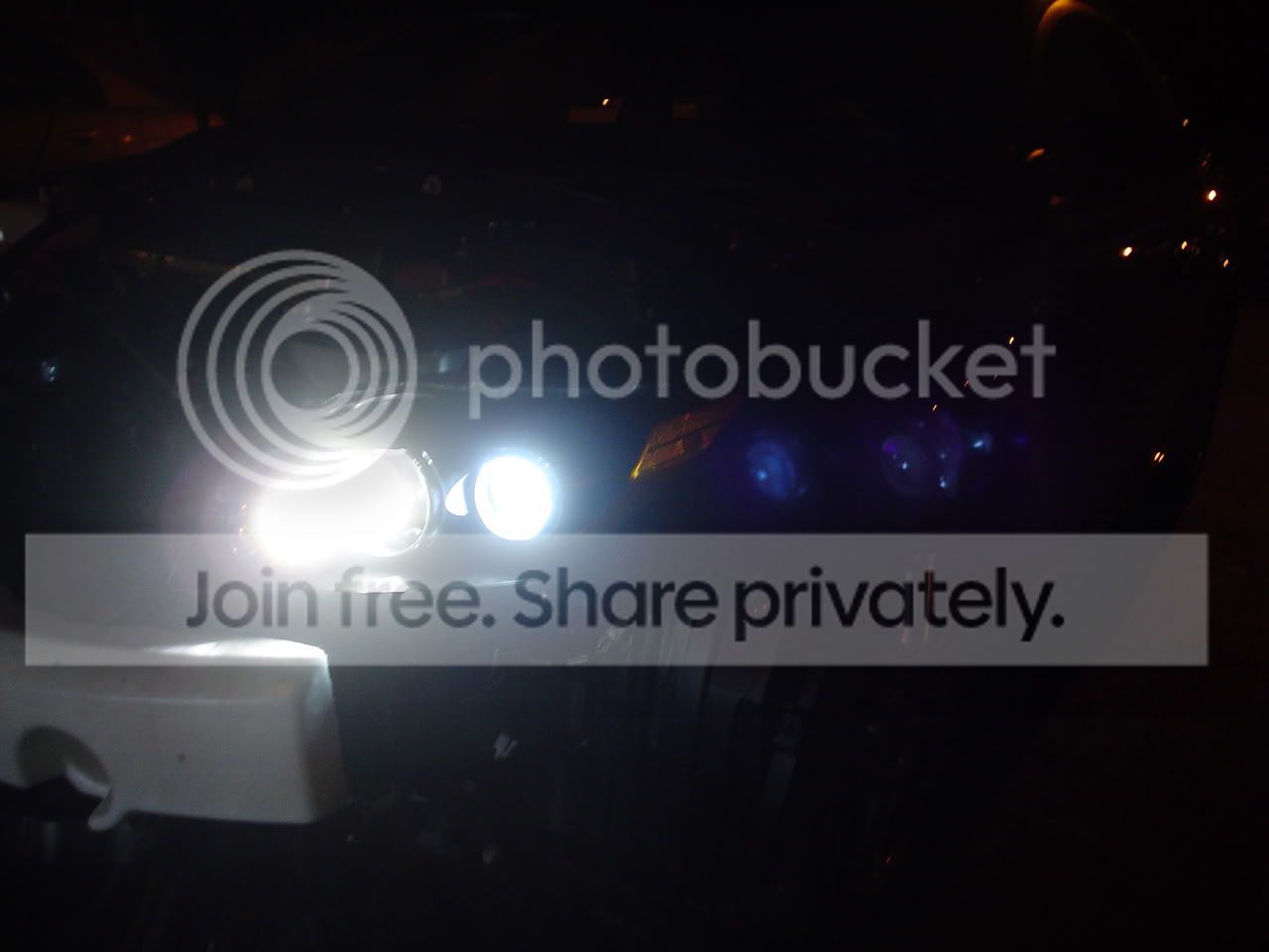

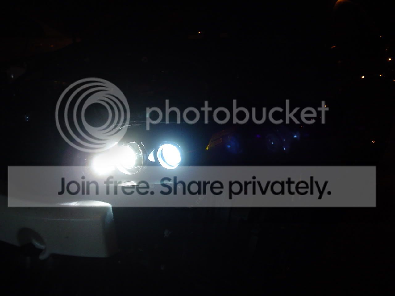

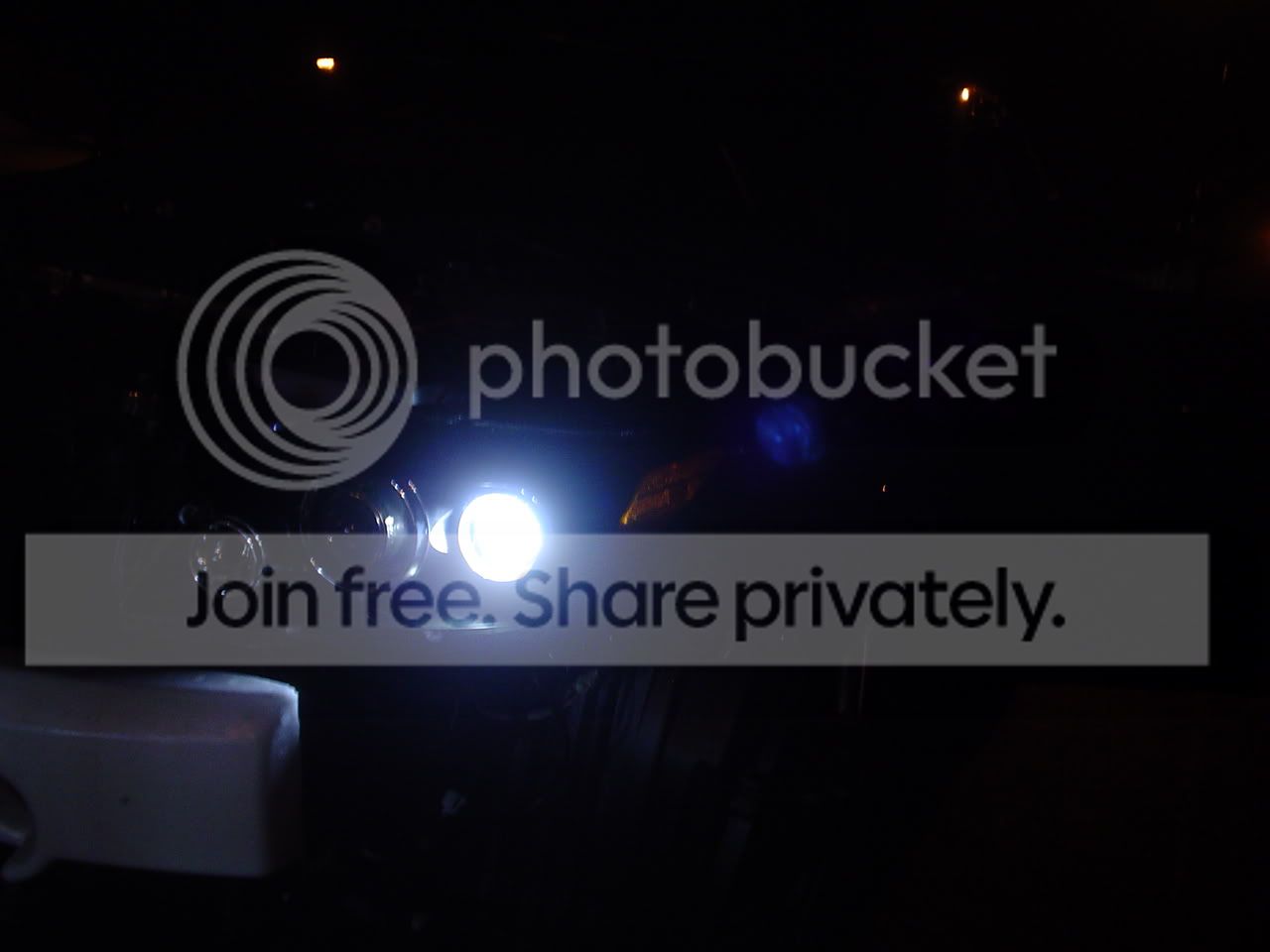

You guys and myself I am sure have been waiting a long time to see the following... I just got them all four installed cutoff pics coming when I get them better aimed. The FX35 Cutoff is level the TSX cutoff is set low because it is slightly uneven. The TSX projectors are not centered in the highbeam slot. Room in there is tight. Install pics coming later I have to get everything cleaned of smudges and put back together before i have to go to school. Hope you enjoy this Midnight snack.
