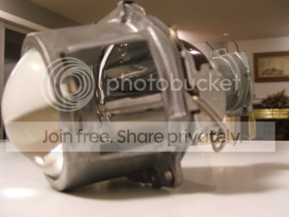

I'm going to try some stuff with the cutoff line. Anyone that works on retro kits or anything like that, I need a little input. What exactly in the light produces the cutoff line? If it's in the projector lens itself...maybe I can rotate the lens and correct it from the inside of the housing?...?

What creates the cuttoff is a shield inside of the projector. Here is a pic of some valeo ece projectors from inside of an Audi headlight. The shield is in front ofwhere the bulb goes in and blocks the light above the cuttoff. It is on the bottom half because with projection the image is inverted.
This is similar to what the projector inside of your housing will look like. You more than likely will not be able to rotate the shield because it is held in place by the two parts of the projector. The reflector bowl and the part that holds the lense. You will need to bake open your lights, which is not complicated or as scary as people say, its very simple and there is a DIY on this site. Tou will need to remove the projectors and rotate them clockwise and counter clockwise respectively untill they are horizontally straght. Then mount them again so they can't move, reheat and seal them. Probably a weekend project. And you might want to get a portable car jumpstarter from home depot so you can power the lights indoors and will not have to do the adjustments while the lights are on the car. Hope this helps. If you need me to explain anything further let me know.

Thx BIGRKtc...
I'll have to take a look at mine and see what I can do to correct it.

ditto, if u wanna rotate it... you will have to do what retro fitters do... BAKE IT and take it apart and figure out how the projector is mounted and all that fun stuff
