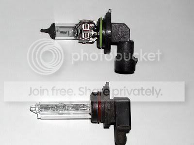

ok well.. here's what I JUST found..
well.. it's juss a thought right now..
You know how HID bulbs have this wire thing next to the bulb then connects on the top of the bulb.
ok here we go.. I know someone is gonna correct me and prolly bash.. so bash away...
I'm not really a light or bulb fanatic... so here's my guess.

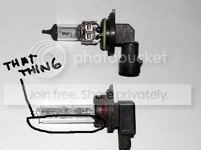

as you can see the HID bulb on the bottom and the wire thing next to the bulb itself. Now I noticed on my stock headlight with my 9006 HID bulb, when set the white wire thing is on the bottom...
But when the bulb is set on the aftermarket headlight on the projector, instead the wire being under the bulb, it's on top of it. Which no way to twist it so i can be on the bottom. Now.. correct me if i'm wrong, If you point a flashlight to the wall with the light on, then with your finger and block some of the light. It's gonna show a dark spot on the wall...
Now my guess is... I think that wire is causing that dark spot

"THAT THING" is a return wire, that is not causing the black spot
is that the bulb you are using?
If you are using the top bulb with that black paint, then that black spot is caused by that black paint
let me know

hmm? No.. i juss got that picture somewhere in google...
-.- thats not even H1 bulb

well im not sure what bulb u are using, im not reading every post in there...
can i see a pic of hte bulb you are using.. better yet, the bulb you are using.. does it have a black painted spot on the top tip? my guess would be that

Actually nakioki could be right. The return wire should never cause a blind spot however when in the incorrect position it can effect output. The return wire should always be in the 6:00 position. Whit real HID if you take a projector and turn it upside down so that the return wire is in the 12:00 position the lght output gets really yellow. Also in these projectors, when the return wire is in the 12:00 positon then it is above the cuttoff shield where the light comes out. Therefore it can block some of the light which comes from behind the shield. If you look at the pic I posted earlier of the inside of the projector, you see where the cutoff comes from the shield. The bulb shines be hind the shield and if a small portion of it is blocked on top by the return it possibly can cause a blind spot.
Problem is that this cannot be fixed. It is the risk you run when using reased hid bulbs that come with kit. A D2S bulb is designed to always fit with the return pointing down, but when you cut it off of a D2S base and attach it to a H1 or 9006, who knows what orientation it will end up with. This doesn 't matter in a reflector because light spills everywhere anyway.
I think this is why people are pushing for umnitza to make a D2S version of their projectors so people don't have to bother with these cheaply made kits and can stick with oem bulbs which cost more than half the price at 75$ per pair.

yeah, it's funny how im testing my projectors and stuff, i rotate my bulb 180 degrees and everything turns yellow
any idea why does this happen
and btw, if you guys get HID kits... they should always have a return wire, and as Big said, it should always be facing down (6:00 position), otherwise, don't get it!
