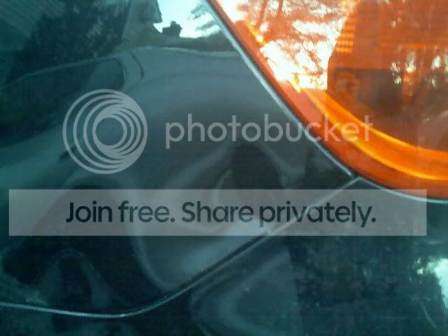

My car got dented. I noticed it when I was walking out of a store in the parking lot. Who knows how it happened. We all know people are inconsiderate of others especially when it comes to these things, so i'm not looking to flame them. I'm not even angry - its sad the way some people act. In any case, i'm looking for advice here. Here is the picture:
The dent is luckily fairly small. It is on the drivers side just above one of the panels (I guess the bumper) and is on what I call the side panel. (it fortunately JUST missed both panels and hit the side panel)
Its in an awkward place to suction it out. From experience, i'd say $200 or so if it doesnt need paint at a body shop. Any suggestions? I know its minimal, but it's my baby...[/img]

Pull the taillight off and I'm positive you'll be able to get your hand behind there and try to work in out. You may be able to even just pop it out.

I don't think that'll work:

as long as the paint isnt cracked, paintless dent repair...im sure they could get it from the inside by removing the interior, as for price, all is different but i recommend lookin into that...should be cheaper then a repair job and with a much quicker turn around, less then an hour labor...

I thought of taking the taillight out and I thought of removing the bumper. I just don't want to go through all of that unless I know that i'll have access to it. I could remove all of the interior in the car, there is mandos' thread on how to, so that shouldn't be bad, but again, i don't know that it will allow me to reach that area.
So you think I should bring it in to a shop? You can see that the paint is fine, so thats not much of an issue.
Anyone think that those suction cup dent removers could work?

from the looks of the picture up there u don't need to remove the taillight. just remove the lil carpeted cover (its the one that just snaps into place with a couple of clips) and u should be able to get behind there. the body shop that installed my old kit shot a couple of screws behind that same place where ur dent is. i don't know if there is enuff room to put a rubber mallet in there but u could check.

Removing the taillight wouldn't do anything, anyway. The cutout behind the light is just big enough to fit the wiring harness into the vehicle. No chance on God's green earth could a man fit his hand through the hole.

no that will not work, unless they drilled an access hole in the wheelwell, but thats usually a last option. the only possible way to reach that area would be from inside the trunk area. i havent had to take the interior apart, so i cant say im 100% positive, but from my experiences on cars that is an area that isnt usually blocked off from the inside. hell if thats not possible, they could also drill an access hole through the taillight housing to reach it probaly. u wont know till u get one of them to look at it...
