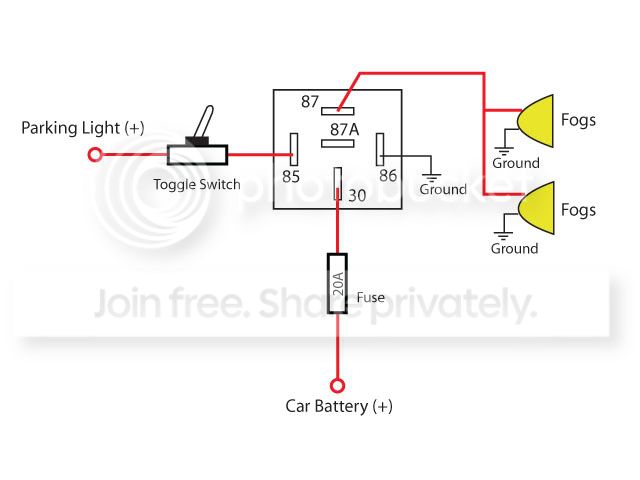

yea i'm going to be doin this also. i have a set of PIAA foglights, i was planning on hooking them up to this. do you guys think i would need anything extra like a relay or something. i mean the foglights have their own relay and switch...how could i go about this?
I think you can use the relay and switch provided. You can wire it like this:
The fogs only turn on if you turn your parking lights and switch on.
