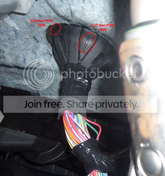

so i was looking in the engine bay today, and i have a question, how do you run a wire back to the switch panel? lol, to me it looks impossible. also where do you mount everything.
Old Jun 14, 2007 | 06:57 PM
Neothin's Avatar
Posts: 7,514
From: Orlando, FL (UCF)
there's a grommet by the pedals
superblue's Avatar
The Family
Posts: 251
From: Dalton, GA
mount the transformers under the headlights. that is were i put mine i just used some double sided tape and stuck it up there. and as far as getting the wire back inside. i found a place were you can run that too. it come out at the steering colum and you can not see any of the wires.
Old Jun 14, 2007 | 07:24 PM
Daskid's Avatar
Posts: 2,170
From: South SoCal, California
Mount the relays between the relay box and the battery. Attach transformers underneath the each headlight assembly. Get a wire coat hanger, poke through the grommet found just above the gas pedal. Cutting is not necessary.
Old Jun 14, 2007 | 10:12 PM
SwtC44's Avatar
Posts: 662
oh dang ok, that answers my question!
