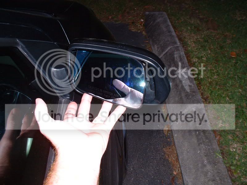

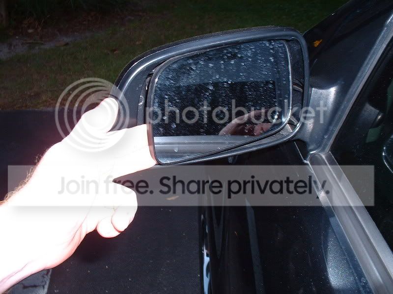

to remove the stock mirror, slip a couple fingers behind the bottom of the mirror slowly pull up until you can get them under the bottom of the mirror and lift it out like this

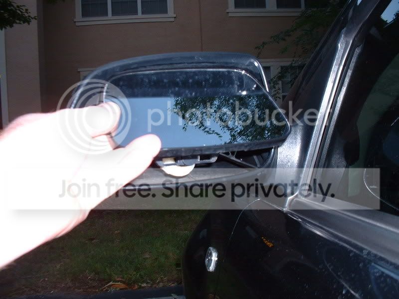

until you have this

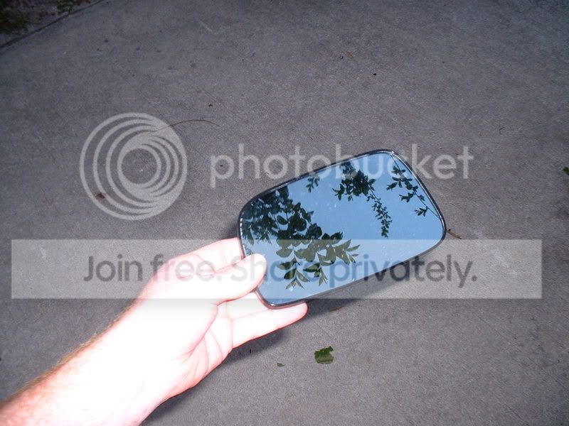

now heat up the oven to 250 degrees and place the stock mirror assembly on a cookie sheet or oven safe cooking bowl, I used an 11x8 glass bowl. heat in the oven for ~5-7 minutes. after heating the plastic will be just bearly soft enough to bend without breaking the mirror, i found it easiest to bend the fat part of the assembly at the sides.

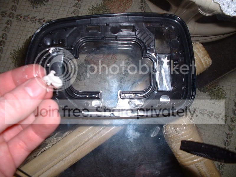

the mirror with either pop out easily or it will be in with double sided sticky backs, one of my mirrors had the sticky backs and the other did not so I got both worlds. now you should have this
now you need to do this quickly, but carefully. take off the backs to the double sided tape that was provided in the kit, I also used the 2 extra pieces of sticky backs on the bottoms of the mirrors for extra holding power. now put the new convex mirror into the now empty plastic mirror assembly.

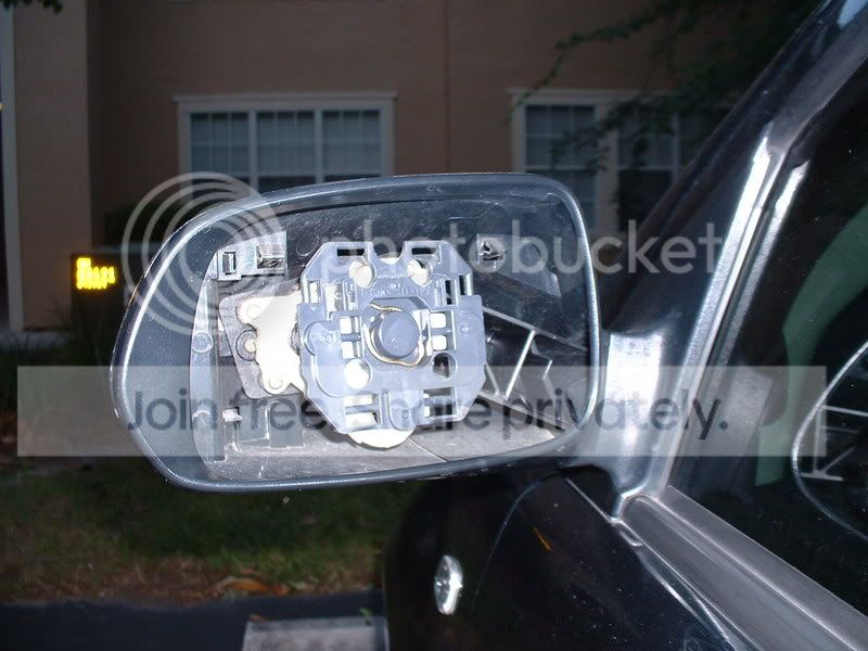

this pic is sideways, but put the mirror back in the housing top first, you should see the clips on the back of the plastic mirror assembly and should notice the notches that it slides into.
put the mirror in top first

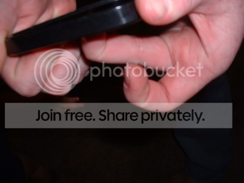

now here is the really hard part of the install. apply enough pressure to the middle (half way) of the mirrors on the mirror side above the sticky backs until you feel the middle clips catch on the housing and then to the bottom of the mirror until you feel the bottoms clip also. PLEASE TRY NOT TO BREAK YOUR NEW MIRRORS BY USING TOO MUCH PRESSURE! the mirrors are pretty strong, so you should not need luck on your side, but you still run the risk of cracking the mirrors at the point if you are not careful.

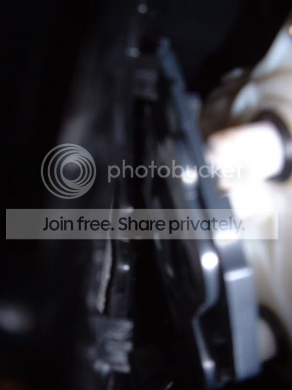

check down the side of the mirror to make sure that all the clips are connected. you will only have about 1/2 an inch to see in this area.

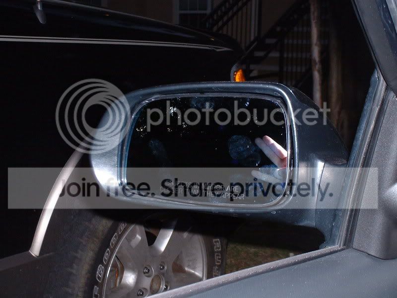

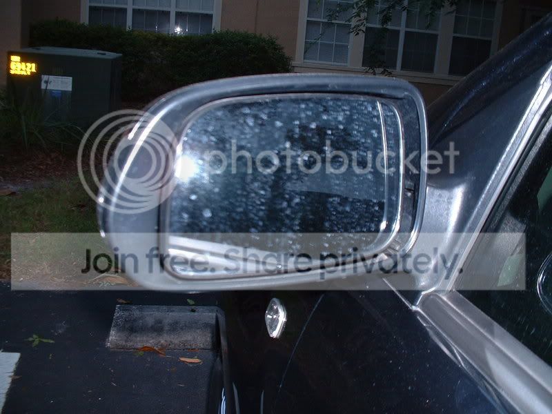

now set your right
and set your left

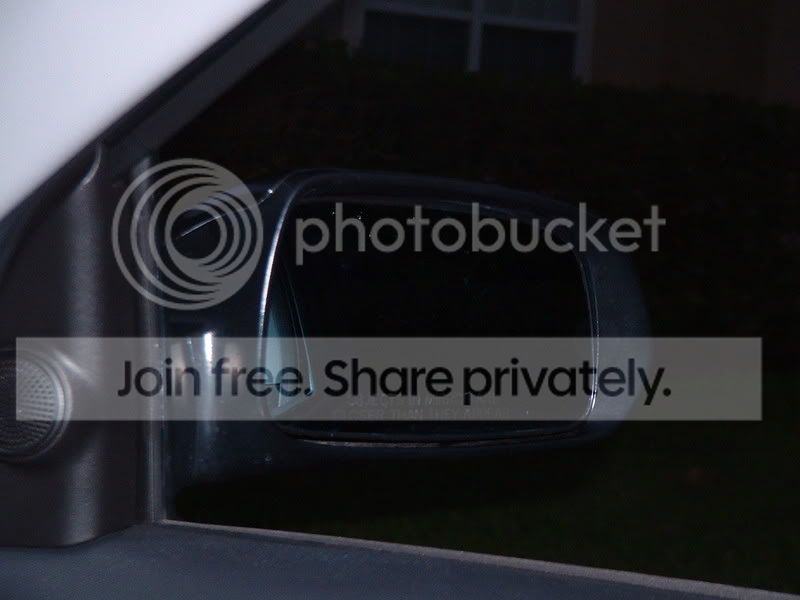

clean mirrors, I didn't yet and...
ENJOY!!!

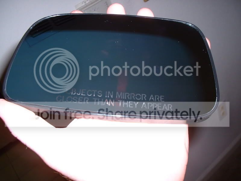

IDEA!!!! two things you can do when installing your mirrors. where is has the lettering of "objects in mirror... yada yada yada" it is clear glass so you see through it. you can either paint the back of the glass a close blue so you dont see it or a contrasting color so the letters will stand out. after seeing how easy they come out now, there is another write up on how to take the back half off while it is still on the car and i am going to see about installing a little heating element in each one and also an led to light up the text slightly =)
