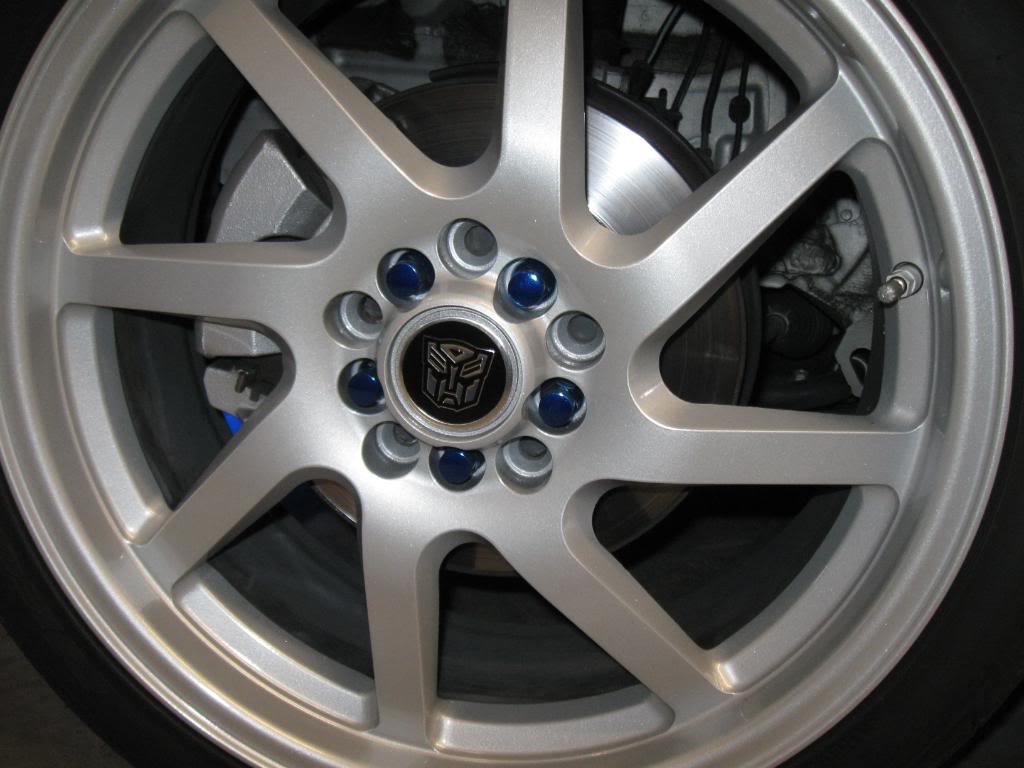

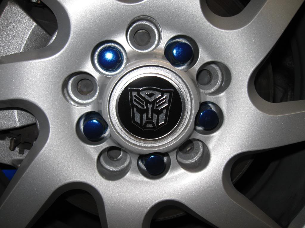

i did some measuring with some digital calipers today on my xd, here's what i came up with. the centercaps on my falken wheels are .25" deep, and 2.55" in diameter. here's what i have now.

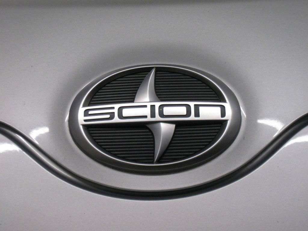

i'd like to have aluminum ones instead of what are basically clearcoated stickers. id mount the new ones to the plastic base i have the stickers on so i can snap them out if needed. i also measured my front emblem badge. i'd really like to get a custom one done with the autobots emblem. i believe its held on with doubleside, as i cant see any hardware coming thru the hood. it measured 5.524" at its widest, and 3.775 at its highest. its looks maybe a quarter inch deep at the most.

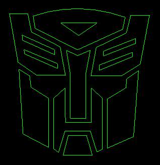

Ok, I worked up the Autobot Badge....
This is with the slight convex surface. If you would rather have it flat that is no problem. I can machine them either way. Flat is actually much easier to machine. This image also makes the badge look really thick, but I cake them the roughly the same thickness as the stock badge. The center caps will look just like the badge, but round.

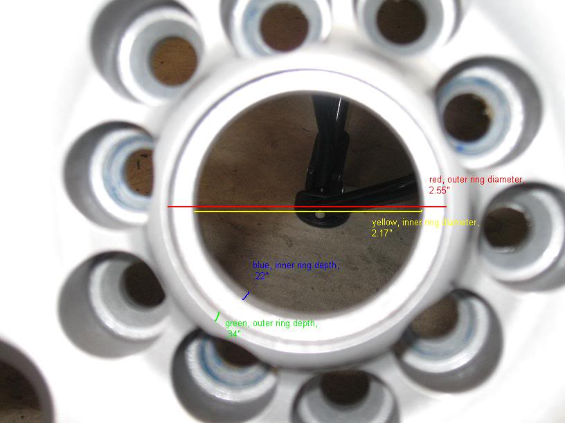

I just ordered a 2.5" x 6ft round bar of aluminum for making the center caps. cobaltbravo, can, you measure the center through hole on your rims? I will be making the center caps to just slip into the rim center hole, and have locking screws on the back side to secure the cap. This way people can't steal them without removing the rim.

Hows this look... I scaled it down 10%

here's the best i could do for measurements. i used the calipers to try and get as accurate numbers as i could. i put them on a pic to explain them. sorry for the crappy image.

Those measurements should be good cobaltbravo. The caps are going to be a close fit to the rim through hole. There will be two tapped holes in the rear of the cap, near then edge. I am going to then make a small slot through each tapped hole. This will create a flexible portion of the OD, which will spread out when each tapped hole has a screw tightened into it. This will create a wedge effect, locking the cap in place. The main point is to prevent someone going up to your car with a screw driver and poping them out and walking. I lost enough vale stem caps that way to Pi$$ me off to no end.... I will try and post a simulation pic to illustrate the locking mechanics.
