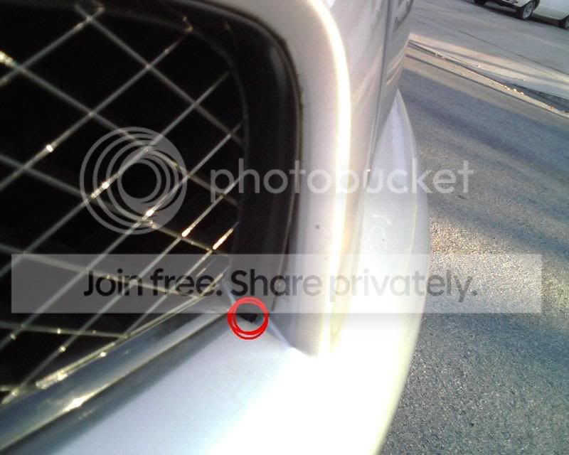

When the grille arrived, I was quite surprised. It is built fairly well, and doesn't feel cheap at all. I eagerly ripped off my stock grille (I painted the badge, but the paint kept chipping off since I speed a lot) and tried to snap on the new grille... for some reason it would get 80% of the way on and wouldn't budge. It turns out that it is not a direct fit, like everyone else has said.
Here's a pic of the areas that needs to be cut (I circled them in red for you):
You could, of course, cut the the area on receiving end of the grill, but you'd need a dremel or saw for that. I was too lazy, and I've cut bumpers before without problem. You could probably cut these bumpers with a butter knife if you really wanted to, but I used my utility razor/knife. What's nice is that if I revert back to OEM, the OEM grille will cover up that little nub.

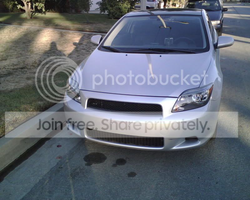

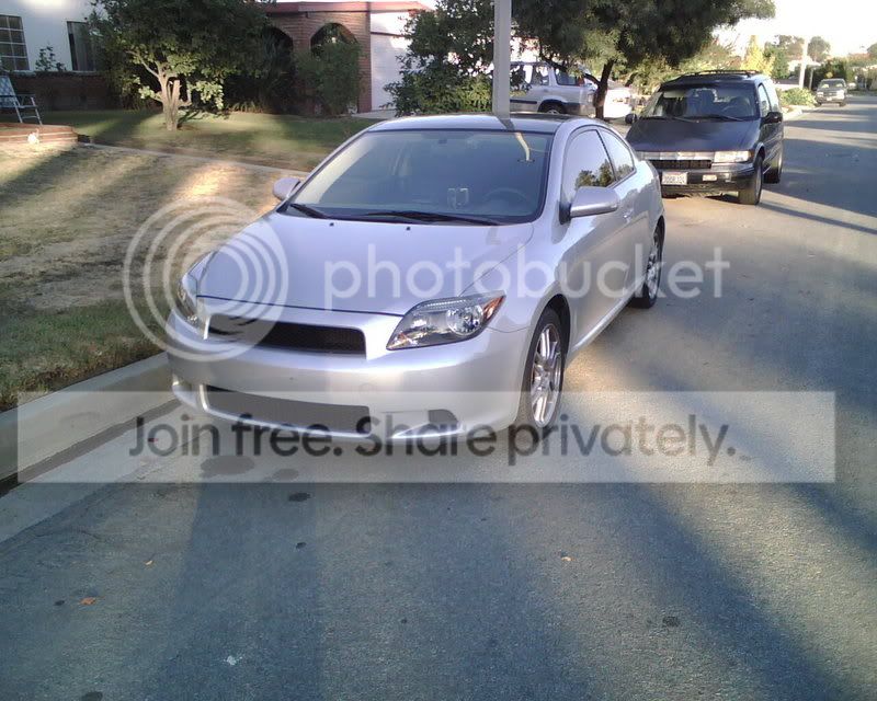

Here are the rest of the pics I took:
Not bad, huh, for a cheap POS eBay grille? The mis-match in grille patterns is not going to win any shows, but this isn't supposed to be a show car either. I just hate that big hulking badge on the front. And guess what? Many cars have mismatched upper and lower grilles. In fact, the 08's come that way, with pretty little tapioca bubbles in the grille. . . eck!
This is a nice cheap and easy alternative to the 08 grilles for those who really hate it (good for you if you actually like it). . . or for those who don't feel like spending $100-$200 on some plastic and wire mesh.

the bottom half looks like it doesn't seat properly. I wouldn't mind buying the thing and just cut up grill to make it fit. would be cheaper and less of a pain than getting a OEM bottom grill and trying to make that fit.
