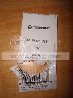

Go to Home Depot and look for "Push In Fastener" they're made of nylon and then you can either buy a rattle can of paint or go to Toyota and get one of those little touch up paint bottles and paint them your self.
Here's an image of what the package looks like..

i did what he did. ^^^ home depot plugs, and got a lil' bottle of touch up paint from the dealer. be sure to slightly scuff the plugs before you prime then paint them.

I used the "Home Depot" type plugs they're talking about, but got them from an auto parts store. They're common, easy to find, easy to install and work very well.

Thanks, I already have the little bottle of paint in FM and i heard about getting them from home depot but i never actually knew what to ask them for, but now i know. thanks for the pic too
