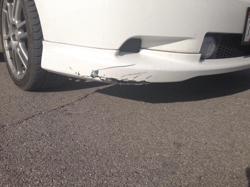

I need some help trying to fix part of my front body kit.
I was turning into a driveway and smashed the front end of my body kit and need to fix it. I have been researching and I don't know if it is my front lip that needs to be replaced or it I need a whole new bumper..? I have posted a picture below of the damage but can't find the correct piece.. Does anyone know how I can fix this or even where I can find this exact piece online?

Drill holes and zip tie it.

It's the OEM Ground Effects lip, link here:
http://www.trdsparks.com/displaypart...7&parts_id=585

easily repair it your self. All You need is Fiberglass cloth + resin repair kit
one of these :
http://www.ebay.com/itm/USC-Premium-...801569&vxp=mtr
http://www.ebay.com/itm/Premium-Resi...8f94d0&vxp=mtr
http://www.ebay.com/itm/NEW-BONDO-42..._Tools&vxp=mtr
http://www.ebay.com/itm/Bondo-420-Fi..._Tools&vxp=mtr
http://www.ebay.com/itm/Professional..._Tools&vxp=mtr
then little bit of finishing putty , sanding, respray and it wont cost you more than 40-50$, depend of your skills after all of this it shouldnt be vissible.
resin drying about 30minutes and its ready to put finishing putty.
dont forget vinyl gloves.
