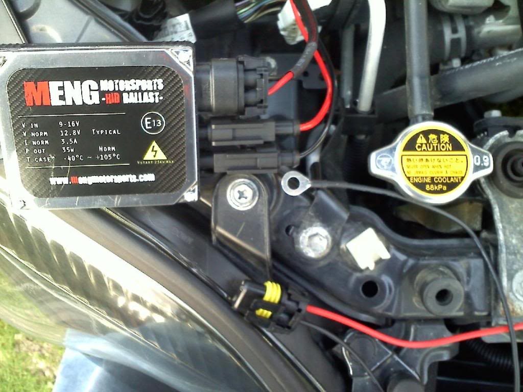

i hooked up my hid lights last night w/out the relay harness. all worked fine. went to hook up the relay, and the drivers side is working , but i cant get the passenger to work with harness.
this is what im looking at . light is hooked up normal and working. and a plug from harness only has poss+, and what i assume is a ground wire leading out of it. how do i hook this up?
from harness i assumed the plug from harness goes straight into the pasg ballast, and ground gets grounded? and that should be all... and the wire which is normaly plugged from headlamp power to the ballast. the one im unplugging , will become obsolete. but when i plug it in like that passg light wont work. anyone clue my into what my problem may be? Name:  20120408171817-1.jpg

Not sure if you saw this, but here's the relay harness install vid from Meng Motorsports.
From what you wrote, it seems like you have it hooked up correctly. The ground and pos+ wires from the harness should be ran to the battery. did you try and flip the plug from the harness that goes into the pass. ballast?

Make sure you have the Correct Ground wire screwed down to the cars frame. Make sure you got the correct wire connected to the car battery.
Make sure the connector is Not upside down plugged into the Ballast too.

you have to ground the wire to the pass side,car frame,theres a small bolt on the side
