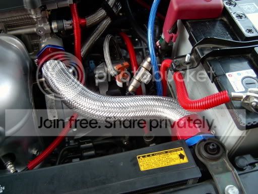

dont sleeve it.. just get a blue Samco hose.. I had NOTHING BUT PROBLEMS when I sleeved my radiator hoses.. all the fluid leaked out twice in like a 1-2 month span.. I thought I did a good job too..

the clamps I was using were not the stock constant clamp ones.. they were screw down hose clamps and they came with the kit, infact the hose clamps themselve were inside a colored end nut housing so there was nothing I could do to change it.. and I noticed that my upper radiator hose wobbled pretty bad (when idling) due to the added weight , that it made the screw come loose.. I constantly had to tighten it.. so I said screw this and just undid it all after both leaks
the leak was so bad that it was all over my transmission housing, all over the back part by the firewall.. pink, sticky radiator fluid everywhere..cleanup was a pain in the ___.
pictures of what the nuts looked like.. inside those 2 end nut pieces were the hose clamp and they couldnt be removed.

doesnt sound like the best setup. They should make the sleeves short enough to leave the very ends of the hose stock so the stock clamps would work. Would not look quite as good, but at least would work properly. But yeah, you can just buy the colored hoses.

so yah.. imagine those 2 pictures, with pink fluid all over the place heh.. it looked cool as hell when it was first done.. but the headache it caused was not worth it..
