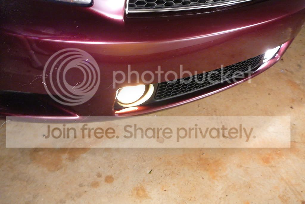

...you have any experience with a company called Advan-Emotion. I bought the OEM fog lights from them and they came in fine, installed fine, but since I was doing it during day light I could not notice until night that the left light was kind of yellowish or a tainted yellow color, while the right one was bright white. I call the company and when I finally got a person, they told me they knew nothing and nor could they transfer me to any one that knew anything. I have emailed them twice and neither time did I get a response. Please let me know if any of you have experienced this company.
So as far as a bulb goes, could the bulb be a bad bulb or someone placed the wrong bulb in? Please let me know

I checked all the connectors and they are fine. the ground is with another ground wire in the body of the vehicle. I know to change the bulbs to see if it is the bulb, but as you stated they are not OEM, but rather OEM style,( should have specified) and getting to these suckers ia a real pain. I will have to take the whole assembly off the car to change the bulbs. Being that they are knock offs, could it be just a bad bulb or they placed the wrong bulb in during assembly? Or is it a common thing if the wiring is bad that one bulb would be tainted.

Here is a pic

like i said, i don't know, and yes, it i shard to get to them, but if you switch the bulbs with one another and the colors change sides, then it sounds like it is a bad bulb.
could just be different bulbs, one is a 55 watt, and the other is a 110 watt bulb. but we can't tell from this end of things.
