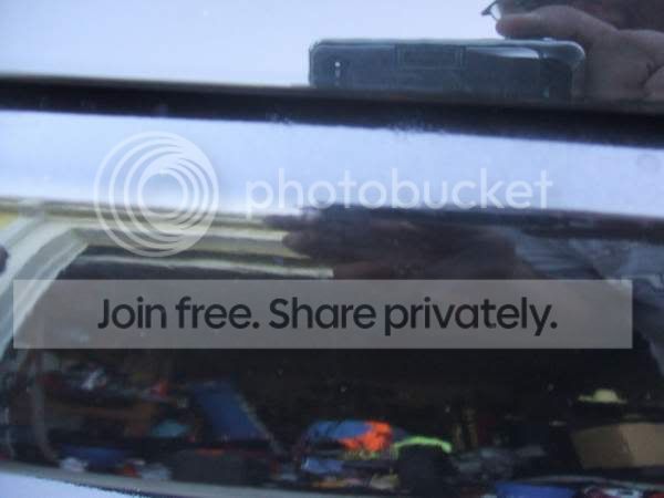

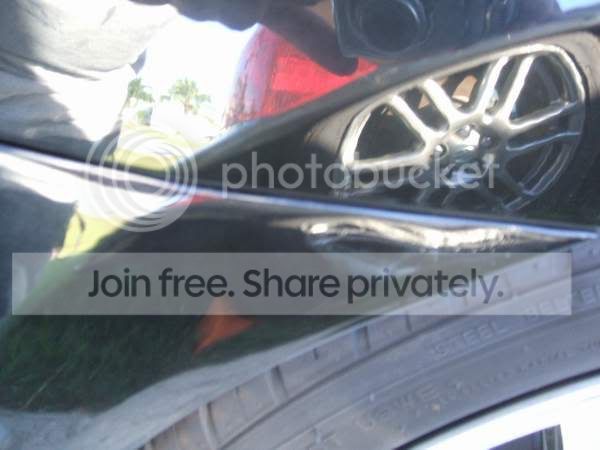

So I got my kaminari kit back yesterday about 4pm. I dropped off at home (4:30pm) and took my car to the car wash to clean it up. I come back home (6:00pm) and we start to install the kit. We get it on and as we finish the rear we notice dimples all in the sides of the rear. I'm like no big deal I take it back and have them fix it (now it like 8:30 and dark). We rinse it of and wipe with hands to remove smudges and some soap or polish that was still on the kit from the shop(?? not sure why).

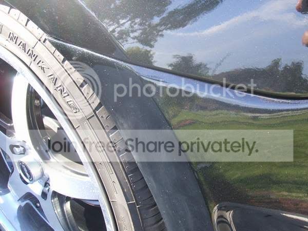

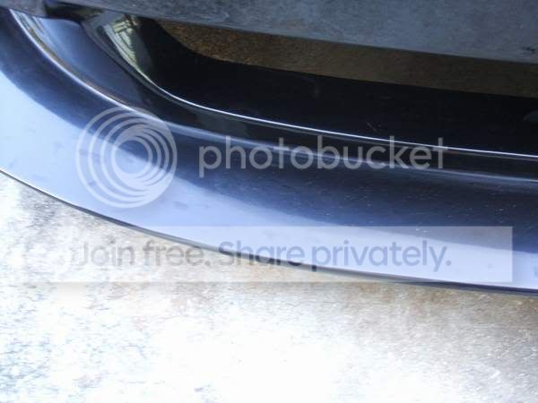

Everything but the dimples looked great in the dark... cut to this afternoon and the more I worked on the car and looked at the kit the more problems I noticed. There's little scratched in it like when the dealer washes your car. It's starting to haze in spots, noticed some more dimples in the front bumper, deep scratches, drops of black paint like if I kid dripped water paint on paper, and spots where it looks like the paint ran and then dried. Is any of this normal?
They said they sprayed something on it, then "bull dog", then the paint. I was told it looked like someone to 180grit sandpaper to it and they didn't noticed till after it was painted and then had to do it over (this is before I picked it, I haven't contacted them about this stuff yet).
Here's some pics.... Oh yeah so the question is any of this normal and if so what and if not should I expect the finally product to look OEM? I know the color will always be off but surprisingly it's not (that I can tell).
Dimples scratching and hazing
Dimples and some scratches
Black water paint looking drops, hazing, scratches
Dimples

Dimples are low spots in the clear that weren't touched when wet sanded but shouldve been touched. The hazing is a lousy buff and polish job after the wet sanding.
To DIY buff and polish go to this thread I made a few days ago. I wouldn't try wet sanding the dimpled areas your self because who knows how much clear is left. have them do it so if they burn through the paint they need to re shoot it.

Would the hazing just start popping up like that after so many hours? When I picked the kit up about 4pm I didn't notice anything but by time 10am the next morning I noticed in the front and then again on the rear at about 3pm. Same thing with the little scratches, seemed like as the day went on we noticed more and more.
The funniest part is the spots we were working by that we could of possibly did the scratching was the side skirts where the door opens and thats fine. I was soldering wires, running wires, pulled the seats out, pulled the door panels off, and everything was fine there.
Also there looks to be like sand or little tiny rock that may have fell into the paint and got painted over. I just hope they fix it with no problems and get it done by Oct. 3rd.

I brought it down their today and the owner was so cool about it all and said they would fix it and that all there work is guaranteed. I'm not used to being treated like that after ZPI and a local shop that did my alarm on my '05.
He wants me to bring it back Thursday and they're gonna keep the car till Friday. He said they should be able to fix the rear and sides without repainting but he said they might have to redo the front. He wants me to wait till Thursday cuz it was painted last Thursday and he said it would be better to wait for the paint to cure more before trying to rebuff and whatever.
