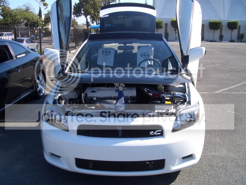

i actually didn't drill any holes..i cut out my old grill and insert the fig grill in to the inside of the molding and ziptied it..fits perfect and has the same affect did it to the bottom as well..granted it takes alot longer but its worth it..no holes in my bumper
