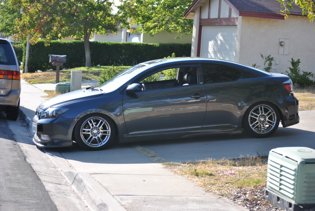

I believe my car qualifies now. haha. I will take new pics later 2day, just wanted to submit my pic.Name:  AA_3-1.jpg
