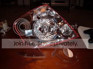

I picked up an extra set of stock tails to try to mod.
I opened up the lights
Taped up the reflective parts I needed to keep
Painted unneccesary chrome areas with satin black paint
Resealed and painted a black outline on the edges to cover the visible line where the lights were cut open and then clear coated them
So now the finished product with a comparison so you easily notice the subtle change.
Stock:
Modded version:

How did you open up the lights?

Unfortunatley the lights are plastic welded together, so the only way to open them is by cutting with a dremel where the plastic back meets the red lens.

What did you use to seal/glue them back together?

Permatex black silicone found at any auto parts store. It's thick, dries pretty fast, and has a rubbery texture to it. Just use alot of it to make sure you have all the cracks sealed.

that looks really nice, i think i might have to try that with the extra set of lights i have sitting in my closet. any special type of paint?

No special paint. I used Duplicolor satin black. I think that's a good choice.... a flat paint might make it look dull and a gloss might end up too bright.
