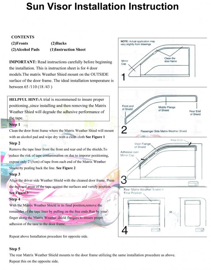

Hi guys!
here is a instruction of the window visor. The process is the same. Please be sure clean the rear glass with water first, then pill off the edge of the 3M tape ( 1 to 2 inches, please see picture 3). Third, align with the rear glass edge. fourth, remove the tape strip while the spoiler is sitting on the rear glass. Last, firmly press down the spoiler for a few sec, this process will allow the tape to bound.
The 3M tape is not design for multiple uses.
Thanks

i put mine on when it was about 40 degrees outside...no problems to speak of. i washed the window with windex and then alcohol before put it on

That's perfect!!
