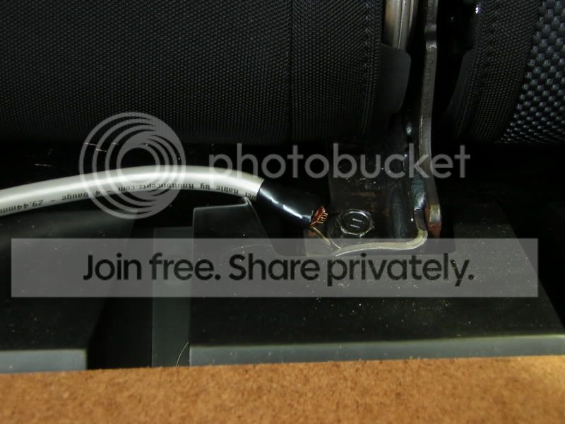

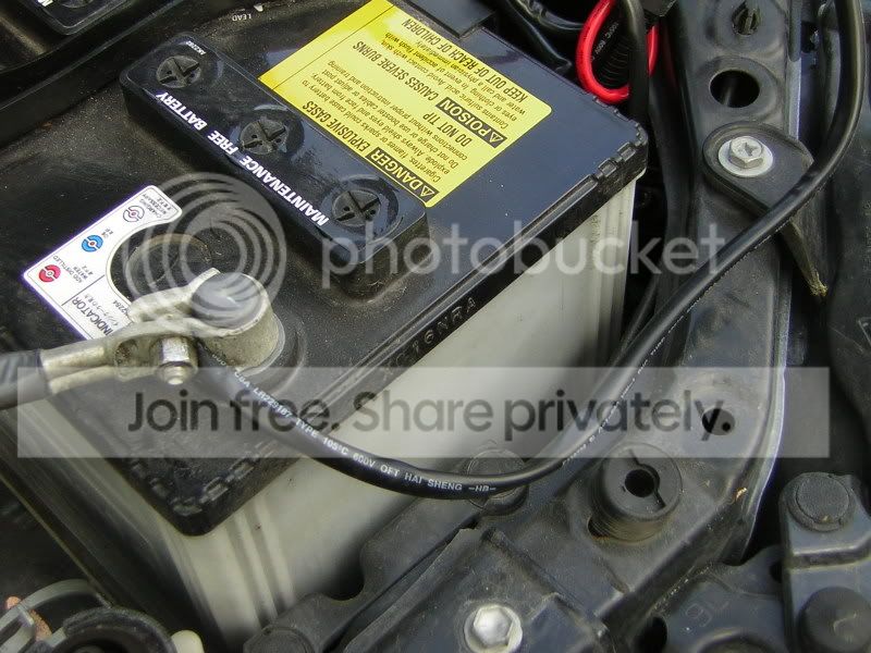

Everything seems to be grounded fine to me. I took some pics just in case.
Old Jan 20, 2008 | 04:26 PM
tweetertc's Avatar
Posts: 566
From: Chicago, IL
YES!!! i love ghetto grounds!!!
Old Jan 20, 2008 | 04:32 PM
mcheng08's Avatar
Posts: 458
maybe you should try grounding somewhere else other then the battery.
