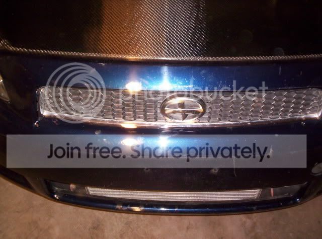

Old Jun 4, 2009 | 05:05 AM

Deep down to the metal?

its supposed to be NBM over a honda black but it looks more like purple and my car got hated on and it got keyed.
Plus it has fenders off of a black tc so it does not go with my honda black two tone.
Reason I got black fenders was because I got rid of my CF ones.

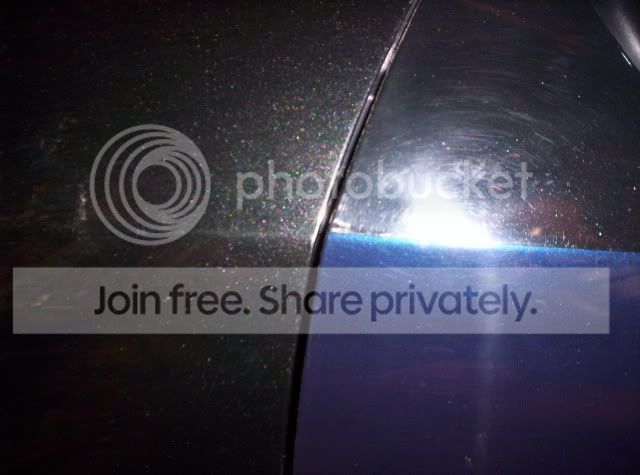

Old Jun 4, 2009 | 05:17 AM

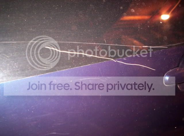

Old Jun 4, 2009 | 05:33 AM

an d ^^ that is what it used to look like. I really want it to look like that again. even better, I miss my car sooooooo bad. kinda tempted in selling my turbo kit for a paint job and bring it back to stock but If i can do it myself than I can have it all.

In your case the prep work is going to be the most important part of the entire paint job. Wet sand down the entire car with 800 grit. Don't wet sand the paint off, just the get the car to look like a dull finish...like below.
Next you're going to have to fill in those key marks with filler and sand them down until they're smooth. The areas that are being filled in will need primer over them and then need to be blocked off.
Mask off the car, begin spraying the door and hatch jambs first....if you intend to repaint those. Apply a light base coat first, followed by a couple more coats. Allow it to dry for a bit and then when the base coat is dry begin applying the clear coat. Light coat and first, dry, medium coat, dry, and lastly a wet coat.
Allow the entire car to dry completely. Color sand and buff.
