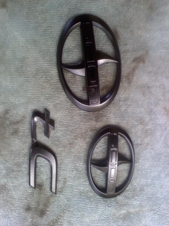

Default Painted emblems
so i finally painted the emblems, i used rustoleum satin black universal paint. i did a little wt sanding with a 400 grit sand paper. no primer or clear. here's some pics from my phone so the're pretty crappy
this is my first time doing this kind of mod so i think it came out pretty good

it came out "okay", but it's not gonna last long without the right prep work... that means using primer... you should also use clear to protect it... if you're going for the flat black look, then use a flat clear, otherwise, they will chip after a few car washes no matter how careful you are... a lot of us have been there and done that... why would you want to make the same mistakes that some of us ( including myself) have made???

Bringing this thread from the dead... It's been almost 2 months since I painted and installed the emblems on my car. I followed your advices and added 4-5 coats of clear. Came out really nice, no peeling or cracking whatsoever. Thks
