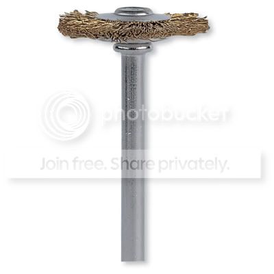

If you want to polish your valve cover, it is fairly simple. All you need is:
sand paper: 320/600/1000/1500.
rotary tool: rotomatic or dremel using a brass brush.
Metal polish

1. Start sanding with 320 paper all around and use the dremel for the hard-to-reach parts

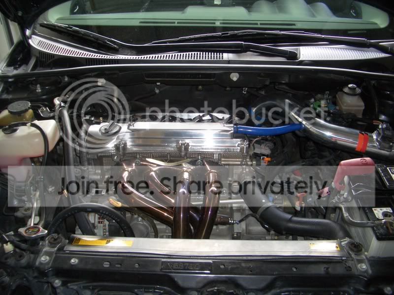

And...... here it is, your shiny engine valve cover.
Now share your pics whenever you are done.

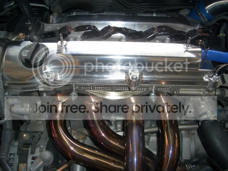

well done dude! but i think you need the chrome oil cap + need to remove the engine cover bolts

good job. i love me some nice polished valve covers.. but i still love my wrinkle red finish.
good job!
question though, how would he remove the cover bolts without dremeling them off?

nice job, seems simple enough....
You did this all without taking it off?
Can I see another pic from a little further away please?

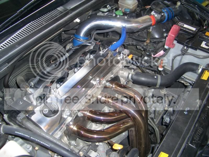

thanks king, and you are right no need to take it off
Here are somo other pics.
Old Oct 4, 2006 | 05:00 PM
Neothin's Avatar
Posts: 7,514
From: Orlando, FL (UCF)
tcpete, they just screw out. i kinda overtightened the nuts that hold the engine cover on and now whenever i unscrew them, the bolts come out of the valve cover instead of the nuts comming off the bolt like it should.

Somebody else is got to try it and post some comparo pics. Oh and by the way this is just as good for the headers, you know to recover the shiny stainless steel look. I might do it this weekend.
