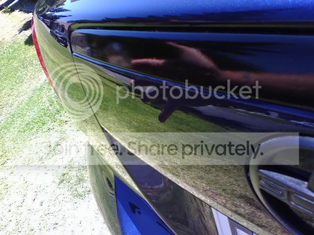

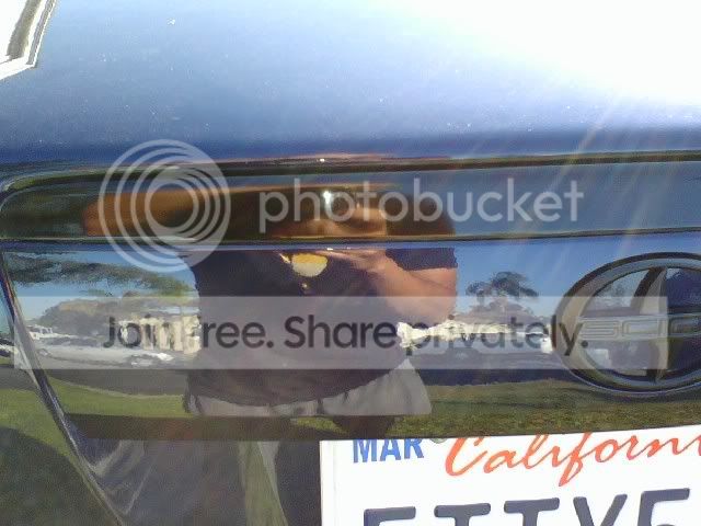

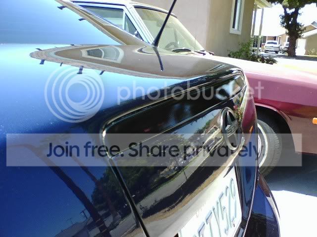

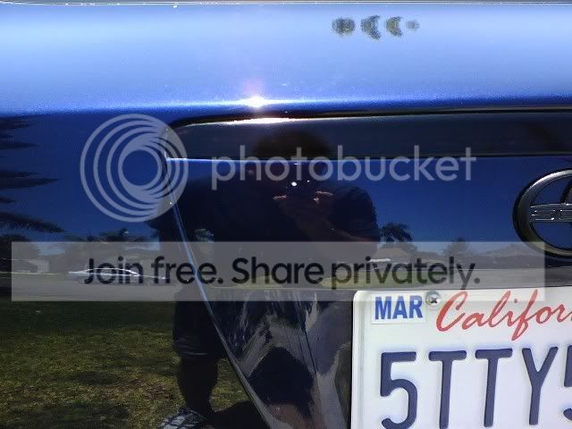

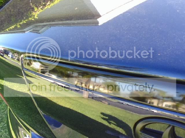

So I finally got it looking good
So I wet sanded with 2000 grit, and used the Turtle Wax Polishing compound, it left the light Super reflective, but left tons of small scratches.
So i then wet sanded it again but instead used Maguires scratch x to polish the tail light. It worked Perfect. It left the light Super Shiny, but without all the little scratches.
My camera phone doesn't really show how much of a difference it was before and after. Here are new pics anyway
