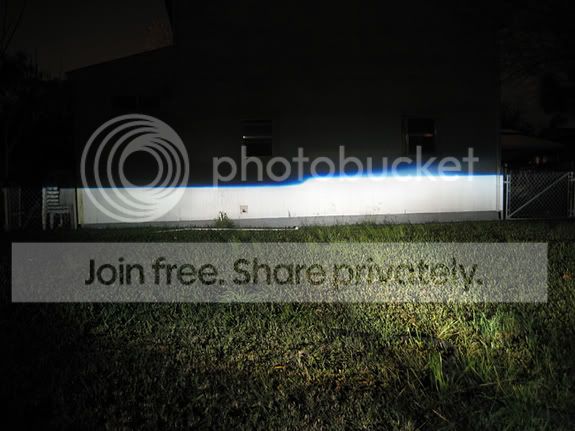

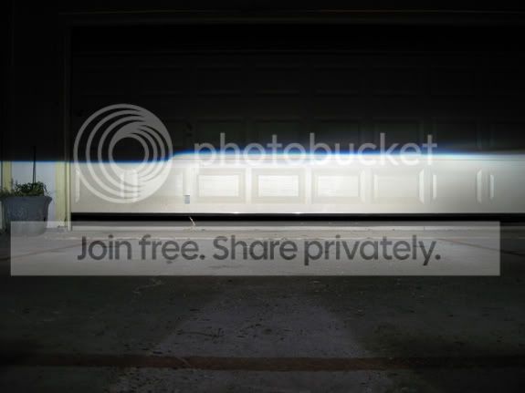

It doesn't matter if you move the 08 projectors back, the hotspot will always be there.
Here is a close up and far away shot of a HID projector:
Close
Far
