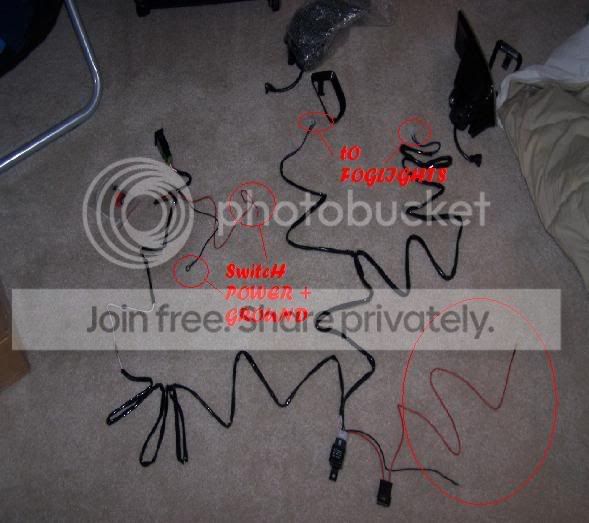

the big red circle are the 2 wires idn where to hook up

the circle in the bottom right is to the battery + and -. The other two are weird. it's next to the switch, which is too far from the battery to conenct there. the only thing I can think of, is if it's a lighted switch, and those wires are to make it light up.

yeah it is lighted, so its just for that i believe... that wont be a problem. So i hook these up right 2 the damn battery? ____ttt

yes, well the positive one anyways. or you can run a small wire from a distrobution block if you've got one from your system. But your most likely puting the switch near the console, so just run a 14ga wire through the firewall and be done. The ground can just use a bolt near the mounting area.
