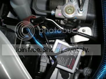

Here is the 10000k Xetronic HID kit that uses the stock tC headlight housing. I figured I do a little bit about it. ZPI sells this kit if interested.
http://www.zeropointindustries.net/s...23ba2faeffdd60
This is an outstanding kit so far. I've had it on since end of October and no problems at all. My main concern was glare due to possible bad cutoff for head on drivers. Not an issue at all. Looks amazing. Install is gravy. No wires to cut and everything works with factory harness.

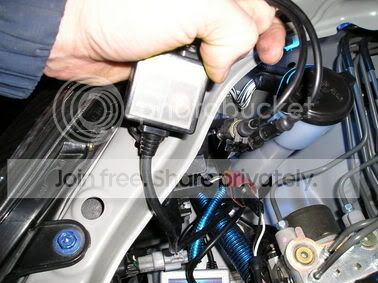

The brown stock connection (went to the stock bulb that fits the housing) plugs directly into the supplied kit connector. There are 2 pins that need to be crimped (solder is better but a good crimp should be fine). These 2 pins (white"+"/black"-" wire) then get pushed into the holes of the black kit supplied connector. Obviously both connectors are keyed. Please note the tab on top of the brown factory connector. In this position, the kit harness white wire (+) is on the right side of the connector. Don't mix this up or you will blow a fuse. If in doubt, check voltage.
The supplied connector even has the ribbed rubber seals for water tight connection. You can also see where I mounted the ballast. On the right hand side you see the hold down bolt. This is factory hole, no drilling needed. Same for the drivers side. There is a spot the ballast fits and and use existing bolt.

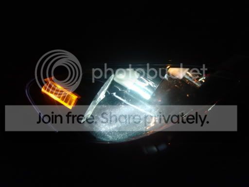

In this pic, the square piece comes from the ballast (hardwired) and has 2 prewired plugs out of it that plug directly into the HID bulb (nice ribbed weather seals). Each connector is keyed to prevent crossing them up (stupid proof ). The bulb then just twists into the stock housing.

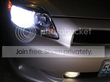

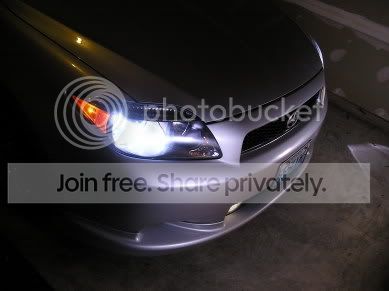

Not a good head on yet...but here are a few. You can see the SILVERSTAR fogs.

They look pretty good. Any In car shots of the roads at night?

wow, 10000K...not much visibility with that. But it looks good still man.

is there a cutoff, hotspots, uneven light patterns of distribution? since it was designed for the stock housing this should have been achived unlike other kits
id like to see a picture too at night?
for 400.00 i hope this kit is addressing all these issues, because if it is id consider buying it......
too bad its only 10k temp
looks good so far
