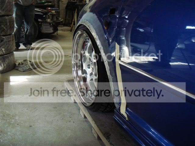

rolling fenders is pushing the fender lip flat against the fender. if you keep rolling the fender will eventually flare outwards.
these guys rolled excessively to the point of flaring

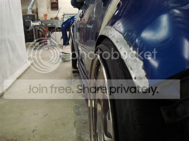

rolled fender on the left, pulled fender on the right (bodywork required)

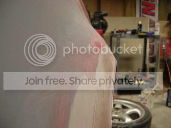

here's a shot of my rear rolled fender. you can see the fender lip disappears as you look up the fender. its not an optical illusion, but the fender lip is actually bent in/flat against the fender. japanese sheet metal is thin, so you can easy F it up (flare the fender or make it wavy). i took my tC to a shop who had 2 guys working on it (one guy using the fender rolller, another guy holding the heat gun).

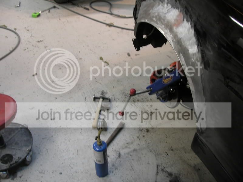

on my old GTI, i rolled the rear fenders myself. the metal is much thicker so there is a reduced chance of jacking it up, although the thicker metal makes the process more laborous.
the tools I used
on my 240sx I used the baseball bat method. unfortunately I have no pics. i only recommend the baseball bat method for people who've tried rolling fenders before.

the rubber/foam trim on the rear fender will fall off exposing bare metal. so cracked paint is inevitable, but luckily the exposed metal isnt visable. i applied a heavy coats of touch up primer and paint on the exposed metal.

but i mean should it ry to take the roller to it again to try to smooth out the waves?
no. you cant fix the waves without bodywork.
this is how to get it fixed properly
