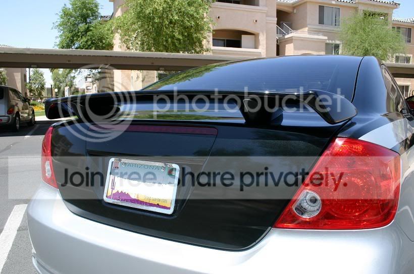

hmm well i see you have a bsp..heres a pic of mine with the hatch shaved to give you and idea..sorry for the crappy quality.

nice, did you fill in the indention for the badge?
am i missing something or does that picture look like it has a 2/3 of the lip spoiler with the middle third missing?
Old Aug 25, 2006 | 10:05 PM
MJVsTC's Avatar
Posts: 2,840
From: Central PA
It's glare.
