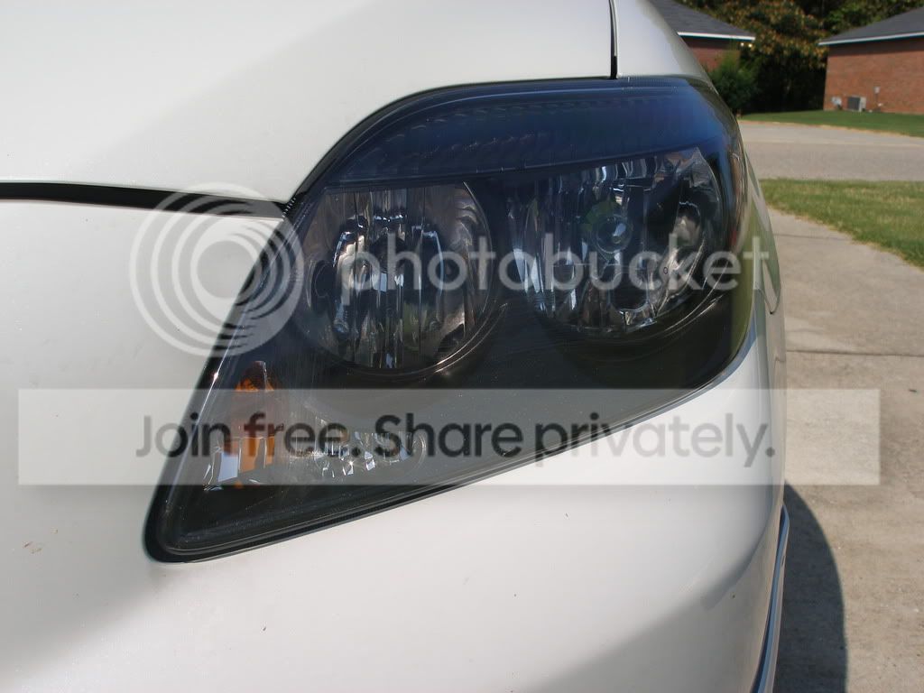

How can i fix this?
A bird shat on my headlight, i went online and found out using Mr. Clean's magic eraser it comes off easily. I guess i read wrong.
Any tips?

try polishing it. Use stuff like Nufinish or liquid glass. If rubbing manually doesn't work, use a buffer. Good luck

Get some Plast-x from Meguiars. That stuff works well, and if you can't get them out by hand, use an orbital buffer. FYI, never use anything even semi abrasive on your plastic pieces. Next time just get some detail spray and wipe it off with a cotton or microfiber towel.

a t shirt and 3m rubbing compound.

I used a Mother's Power Ball (the one made for plastics, not paint) with Plast-X polish and it worked very nicely. Good luck!

Seriously try meguiars PlasticX or a few coats of wax

Agreed! I had scratches on my headlight lenses due to not being careful in the garage when I had them apart... I was planning on tinting them, that's how bad they were, but needless to say, the scratches are now gone!

bring it to a body shop and have the wetsand and buff it out. those scratches don't look to bad

buffer+ 3m rubbing compound or PlasticX = clean light!
