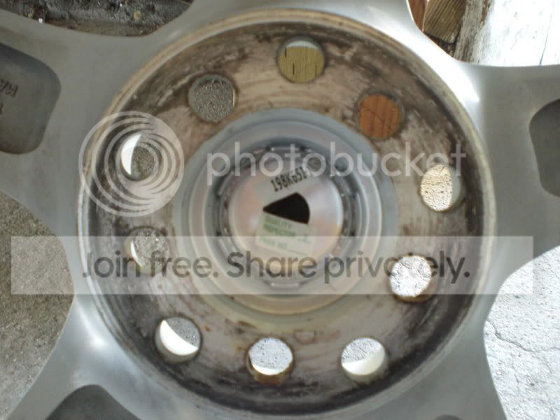

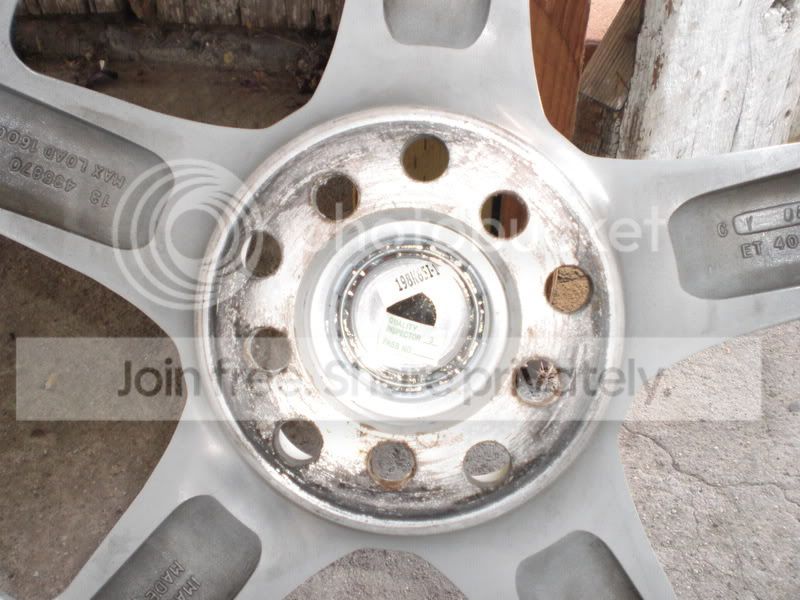

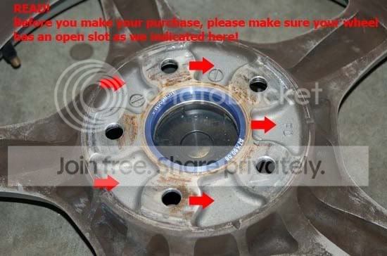

I also have a question regarding the space on the back of the rim as shown in the pix below.......
Mine does not have that .........is that going to be a problem if i get spacers?
